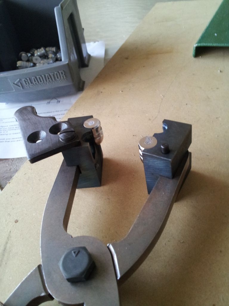

My rig, an RCBS Promelt Bottom Pour
A fresh pour into my 250gr flat point round nose .452 mold
Kicked off the sprue
Opened the sprue, removed the sprue material, and opened the mold to reveal.... BOOLITS!!!
Dumped out the BOOLITS!
LOTS OF BOOLITS!!!

Sure are purdy. Congratulations.
When I knock the sprue off, I put it straight back into the pot after each cast. Helps me to keep a more consistent temperature if I add just a little lead back each time instead of getting a whole pile of sprues built up and then dumping them all in at once.
Once my mold is hot enough to move the sprue plate with my hand instead of a mallet, then I just hold the mold up over the pot, twist the sprue plate and drop the sprue back in all in one motion.

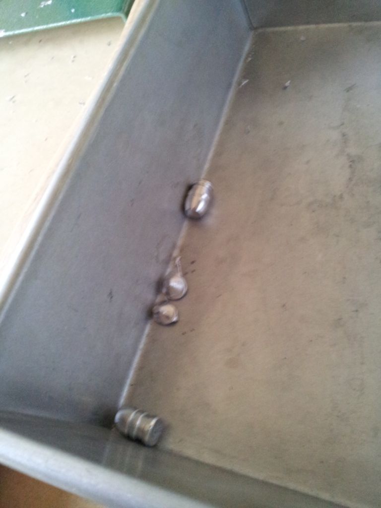

Good suggestion, Jumping Frog.
Also, if I may suggest...I can't tell if you did this, but...dropping them straight into a metal pan isn't really ideal (causes dents). I've always used a cardboard box with a folded up towel as a "landing pad" for my boolits (.58 minies, in my case)
P.S. - Congrats!! :thewave

I also like to use a towel to drop bullets onto.

OldCannon wrote:. . . (causes dents). I've always used a cardboard box with a folded up towel as a "landing pad" for my boolits ...
Good reminder. Yes, I do that too. I've got an old towel that has been used for bullet casting for years. Needless to say, it is never going into the washer or being used for any other purpose.
