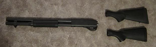

It has an 18.5" barrel and magazine tube extension to make it as long as the barrel for 6+1 capacity.
I stand 5' 7" in shoes (5' 6.5+" when barefoot) and no one's ever accused me of having really long arms, and I have a fairly thick chest. Most factory stocks are a touch too long for me. Most long guns seem to have a length of pull of about 13.5" or a little better. I like about 13" or even a little shorter, down to 12.75"
My new 870 was, by my measurement, 13.75" LOP, way too long for my comfort.
I bought a shorter SpeedFeed brand stock through Scattergun Technologies (Wilson Combat) and installed that.
You can see that the SpeedFeed short stock (bottom) is considerably shorter than the Remington factory stock (top).
On the gun, it's about a 12.75" LOP. That's almost too short, but it's almost the exact same length as my old Mossberg 500 20 Ga which I hunted with as a teenager and with which I'm still very comfortable.

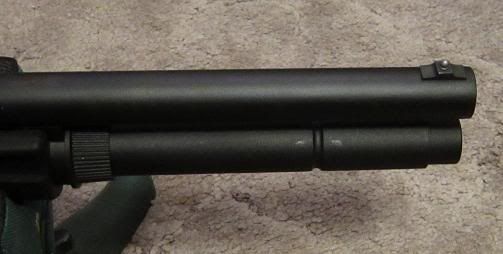

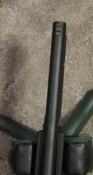

Today I received an XS tritium sight. I ordered it off their website: http://www.xssights.com/index.php?nID=s ... ID=shotgun" onclick="window.open(this.href);return false;
(Bottom right corner of that page, "Big Dot Tritium Remington pedestal barrel."
It epoxies on over an existing bead sight.
Before:
Image Image Image

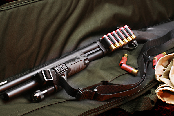

Tomorrow, more goodies from Scattergun Technologies are expected on the brown truck. :hurry:
This, in particular:
So, stay tuned for updates. :cool:
