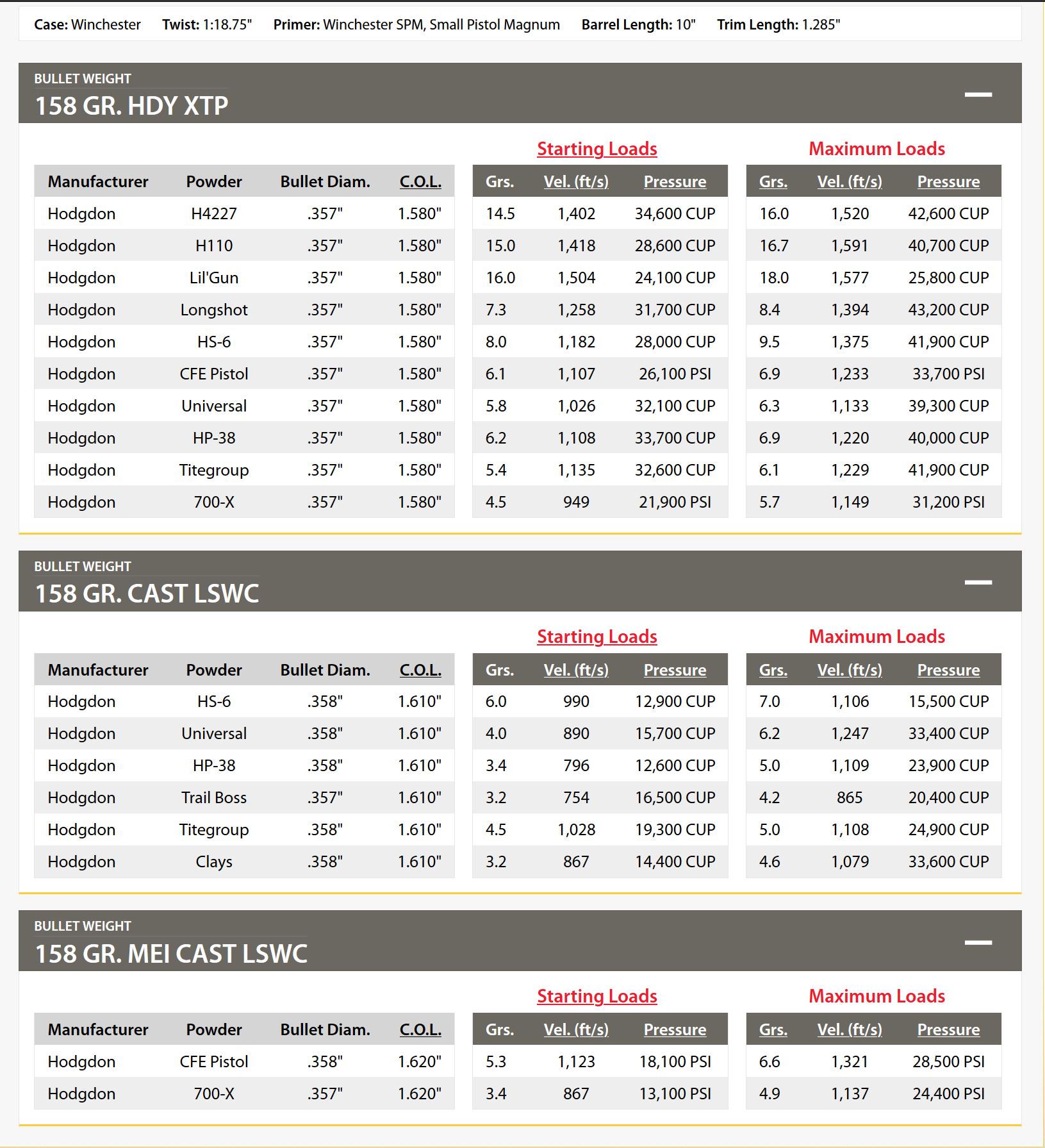

See attached.

I should also point out for those who view Hodgdon's data that the velocities shown came from a 10" test barrel. How they can find that relevant while 4" barrels are the most common is a head scratcher. But hey, it looks good in the data!
