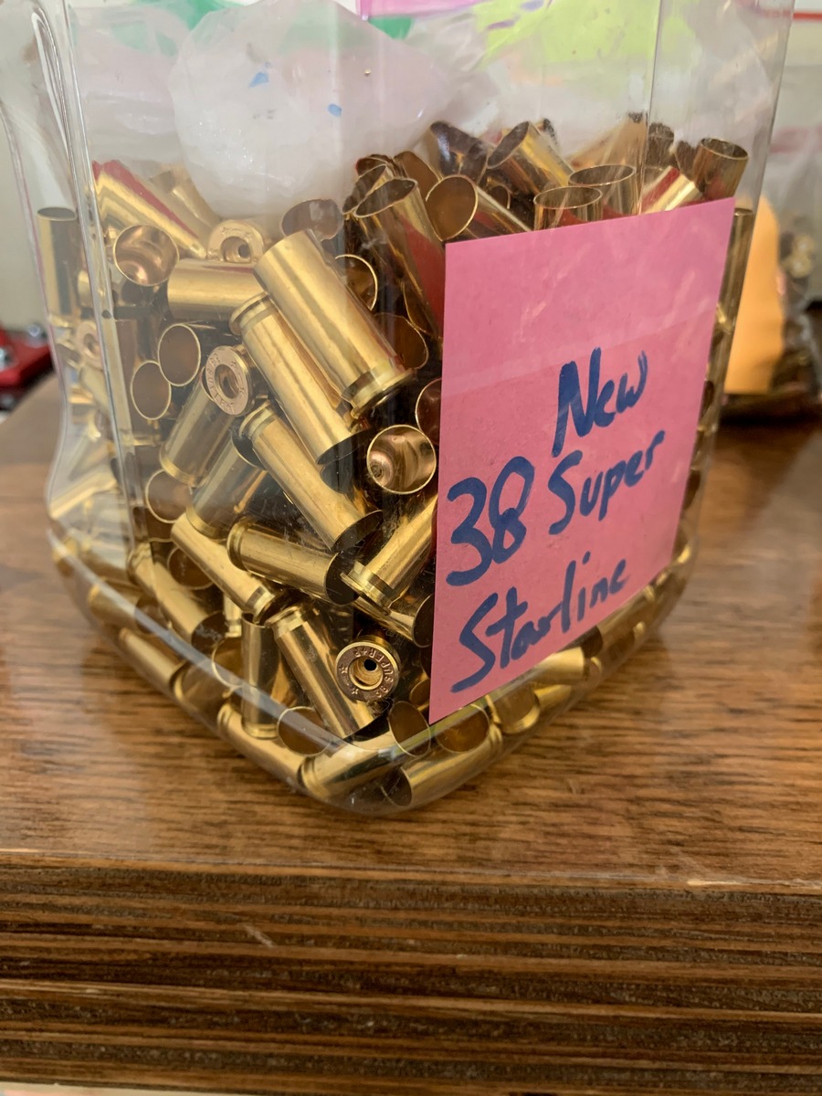

That's a deceiving statement and not completely accurate. Both processes uses car wax to preserve cleaned condition. I use AA Wash & Wax as my soap and add a dab to my rinse water. Here is a batch of brass, untouched for years... no fancy lighting, just a phone pic through the plastic bucket. It's not tarnished at all and still is like new. 2nd pic is new Starline brass for comparison. I have some brass that's 4-5 year old since cleaning with same or better appearance, just too lazy to go dig out for a pic for this post.orionengnr wrote: ↑Thu Dec 17, 2020 10:47 pm I looked into the wet tumbling process several years ago, and have not gone there...so no need to "go back".
For me, the greatest advantage of the dry process is (using some Nu-Finish every now and then) that my brass has a thin coating of wax/polish and stays tarnish-free in storage for 5 years or more.
Using the wet wash with Lemi-Shine strips everything off the brass and it tarnishes almost immediately.
No, thank you.
You can screw up either cleaning process if you do it wrong.

Re: Article: What’s The Best Way To Clean Brass?
I wish I could get the results y'all get. I wet tumble to get the brass clean (and hopefully the primer pocket as well but that does not always happen). When the brass first comes out of the wet tumbler, it is bright and shiny. It doesn't take long for it to start darkening. I started out using Dawn dishwashing liquid then learned about lemishine and started adding that. Then I learned about the car wash and wax liquid and tried that. I still have to dry tumble to get the brass shiny (so that I can find most of them on the ground) and, on really dirty primer pockets (mostly from Winchester primers) I have to hand clean them. What am I missing? I use the pins that came with the tumbler and run about 425 - 440 each of 45 ACP (deprimed) at a time. I rinse the brass three times with hot tap water to make sure I have all of the soap off of the brass.
Help!
Make a smaller batches at a time. Say 250 rdsLTUME1978 wrote: ↑Fri Dec 18, 2020 2:54 pm I wish I could get the results y'all get. I wet tumble to get the brass clean (and hopefully the primer pocket as well but that does not always happen). When the brass first comes out of the wet tumbler, it is bright and shiny. It doesn't take long for it to start darkening. I started out using Dawn dishwashing liquid then learned about lemishine and started adding that. Then I learned about the car wash and wax liquid and tried that. I still have to dry tumble to get the brass shiny (so that I can find most of them on the ground) and, on really dirty primer pockets (mostly from Winchester primers) I have to hand clean them. What am I missing? I use the pins that came with the tumbler and run about 425 - 440 each of 45 ACP (deprimed) at a time. I rinse the brass three times with hot tap water to make sure I have all of the soap off of the brass.
The only "trick" [if you want to call it that] is that after I've rinsed, I throw the separated brass into a colander, sitting in a tub of hot water with a tsp or two of armor all wash & wax mixed in... just swirl it around and let sit a minute. Then dump out to dry. The hot water rinse heats the brass and helps the wax penetrate and helps them dry fast - in a couple minutes after dumped on a towel. (I do run a small fan over them to aid in quick drying- but that's for my own convenience) The wax in the final rinse water keeps them looking same for years (so far).LTUME1978 wrote: ↑Fri Dec 18, 2020 2:54 pm I wish I could get the results y'all get. I wet tumble to get the brass clean (and hopefully the primer pocket as well but that does not always happen). When the brass first comes out of the wet tumbler, it is bright and shiny. It doesn't take long for it to start darkening. I started out using Dawn dishwashing liquid then learned about lemishine and started adding that. Then I learned about the car wash and wax liquid and tried that. I still have to dry tumble to get the brass shiny (so that I can find most of them on the ground) and, on really dirty primer pockets (mostly from Winchester primers) I have to hand clean them. What am I missing? I use the pins that came with the tumbler and run about 425 - 440 each of 45 ACP (deprimed) at a time. I rinse the brass three times with hot tap water to make sure I have all of the soap off of the brass.
Help!
Smaller batches can help or depending on your tumbler, more pins/shreds.
