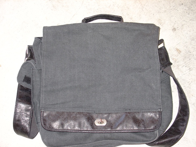

The front of the bag

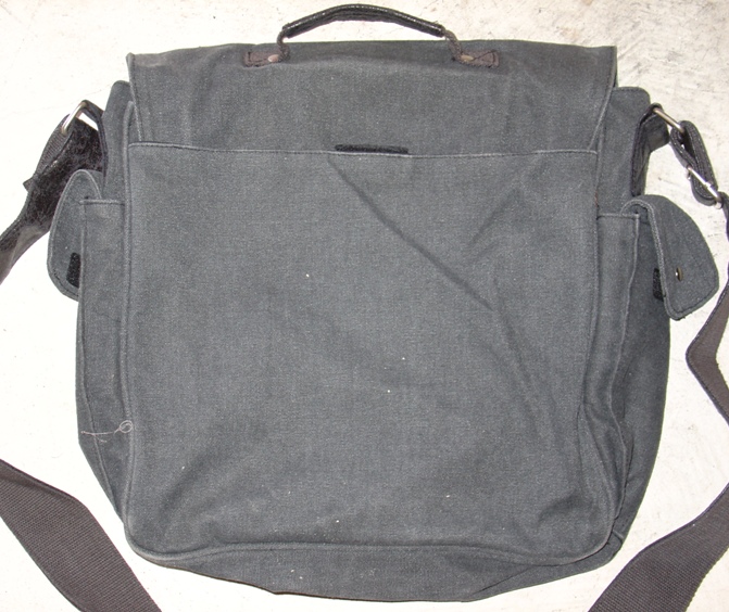

The back of the bag

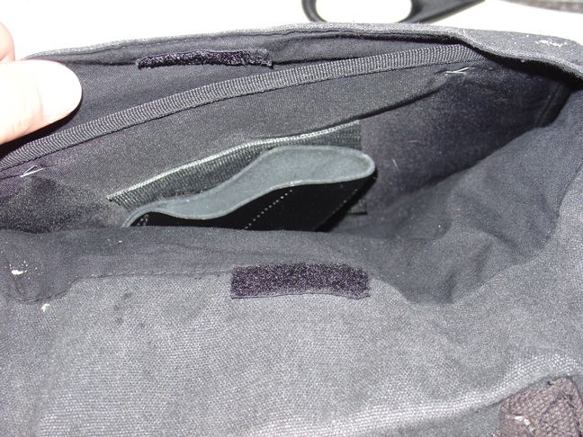

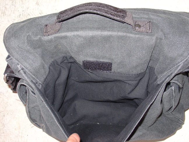

Here is a view inside the "body-side" pocket where the holster will go.

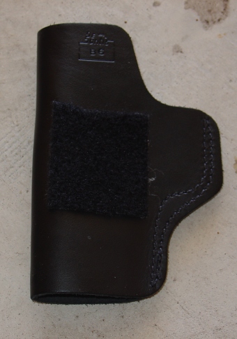

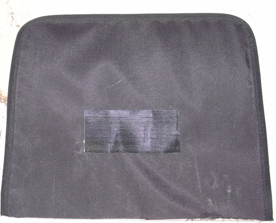

Now you need a donor holster. You pick whatever you want. I had a DeSantis "Insider", and I cut off the clip. The holster is going into this body-side pocket, so that it can be accessed without opening the front flap. You could just sew in a holster, but if it has remotely decent retention then the pistol won't come out without just lifting the whole bag. This particular canvas bag is way too floppy to work that way anyway, as are all of my messenger bags, so they would just fold up on top of themselves. So my solution is to use a panel as a stiffener inside this pocket, and affix the holster to the panel. I had a couple of "dividers" that came out of a laptop bag that I cut to fit in this case. These are just cardboard with nylon on top. Anything will do here. In fact I originally planned to use a plastic container that we were discarding, just cut the side out of it, but it was discarded by the time I got around to doing this.
Measure the size of your pocket, being sure to leave clearance for the velcro or whatever holds the pocket shut, and then cut your panel to fit. Put some velcro on the panel so you can stick your holster on there. Note only one piece of velcro is stuck on in this picture but I actually put three strips like this on there to make it easy to stick the holster anywhere I want it. Next up you need to put some Velcro on the holster, so it will stick to this panel. You could attach the holster by other means if you prefer... rivets, sew it, whatever works for you. I like Velcro because I can re-position it or change to a different holster, remove altogether if I want.
Note in my picture, there is just a small patch of Velcro. This didn't prove substantial enough so I actually put Velcro on the entire back side of the holster.
Note also, the stiffener is going between the holster and your body, so for a right-handed holster and right-hand draw, you will want to put the velcro on the left or INSIDE of the holster (as if it were a clip on an OWB holster).

Here's how it looks from the back with the panel securely stapled in: Then stick your holster in the position where you want it, and you're done.
Here we are with the holster in the pocket: That's it. Now you have a CCW messenger bag.
