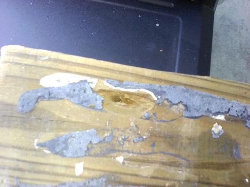

update
yesterday for grins i took a 4x6 pressure treated piece of lumber (dried) and at 20 feet fired one 185 grn RNHB FMJ and one 185 grn SWC
same powder load and same powder (western and accurate #5)
the rn nose went clean through the wood, while the swc is somewhere about 3/4 in the wood.
