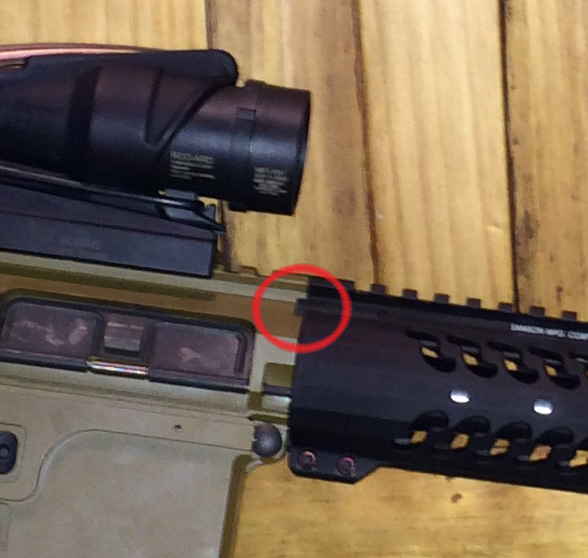

I really like it. It's a 15" rail, but it's noticeably lighter than the 12.5" Yankee Hill Machine "Lightweight" rail I had on it before. Also, it is more slender, and without the additional side and bottom rails, it is easier on the off hand than the YHM rail.
The only caution is during the mounting. My son found a YouTube video from Samson describing the proper installation procedure:
[youtube]http://youtube.com/watch?v=xKyIoy0csqo[/youtube]
Pay special attention at about 3:50 into the video. There's a helpful hint there. Also, the "anti-rotation" tabs at the rear of the rail which line up on either side of the receiver (see image below) are designed to fit on either side of a standard receiver. I have a matched set of upper/lower billet receiver halves, and they are a little bit beefier than standard. That means that we had to gently take a file to the inner surface of each of those tabs so that they would fit the receiver between them. It was only a tiny amount that had to come off, but I've seen other YouTube videos that mention that you might have to do that. But again, it shouldn't be a problem if you have a standard receiver.
Interestingly, even though I now have an additional 2" of heavy barrel and 2.5" more of rail, the overall effect of the change is a lighter, handier feeling rifle, which ought to shoot like an absolute tacdriver. I can't wait to get my bolt/carrier parts back from the plater's (viewtopic.php?f=23&t=73060" onclick="window.open(this.href);return false;), and then I'm going to take it out to the Parker County gun club and get it re-zeroed. Then I'm going to take it over to the 250 yard line and see what she'll do.
