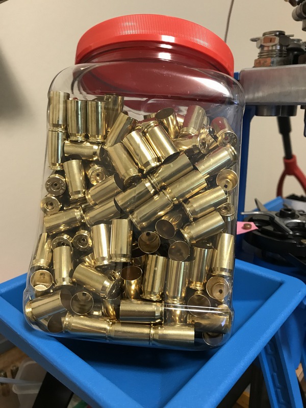

Once, I saw the first batch out of my Arsenal Rotary tumbler, I never looked back. I used Hornady Ultrasonic cleaner before, now it is collecting dust unless I need to clean some gun parts.
I have both SS pins and SS shreds, both works very well. If you clean straight wall pistol cases just stick with SS pins.
https://photos.google.com/share/AF1QipM ... 1BYlV3NmRB

I have to admit that's impressive.Beiruty wrote:Once, I saw the first batch out of my Arsenal Rotary tumbler, I never looked back. I used Hornady Ultrasonic cleaner before, now it is collecting dust unless I need to clean some gun parts.

Re: Brass Cleaning
Thanks guys for the good info.
I think I will try the walnuts first and in the summer jump to the Harbor Freight wet tumbler.
I did not start tumbling with corn cob till the late ninetys and I guess I am just getting pickey.
Those in the photo look like factory.
Again thanks .
