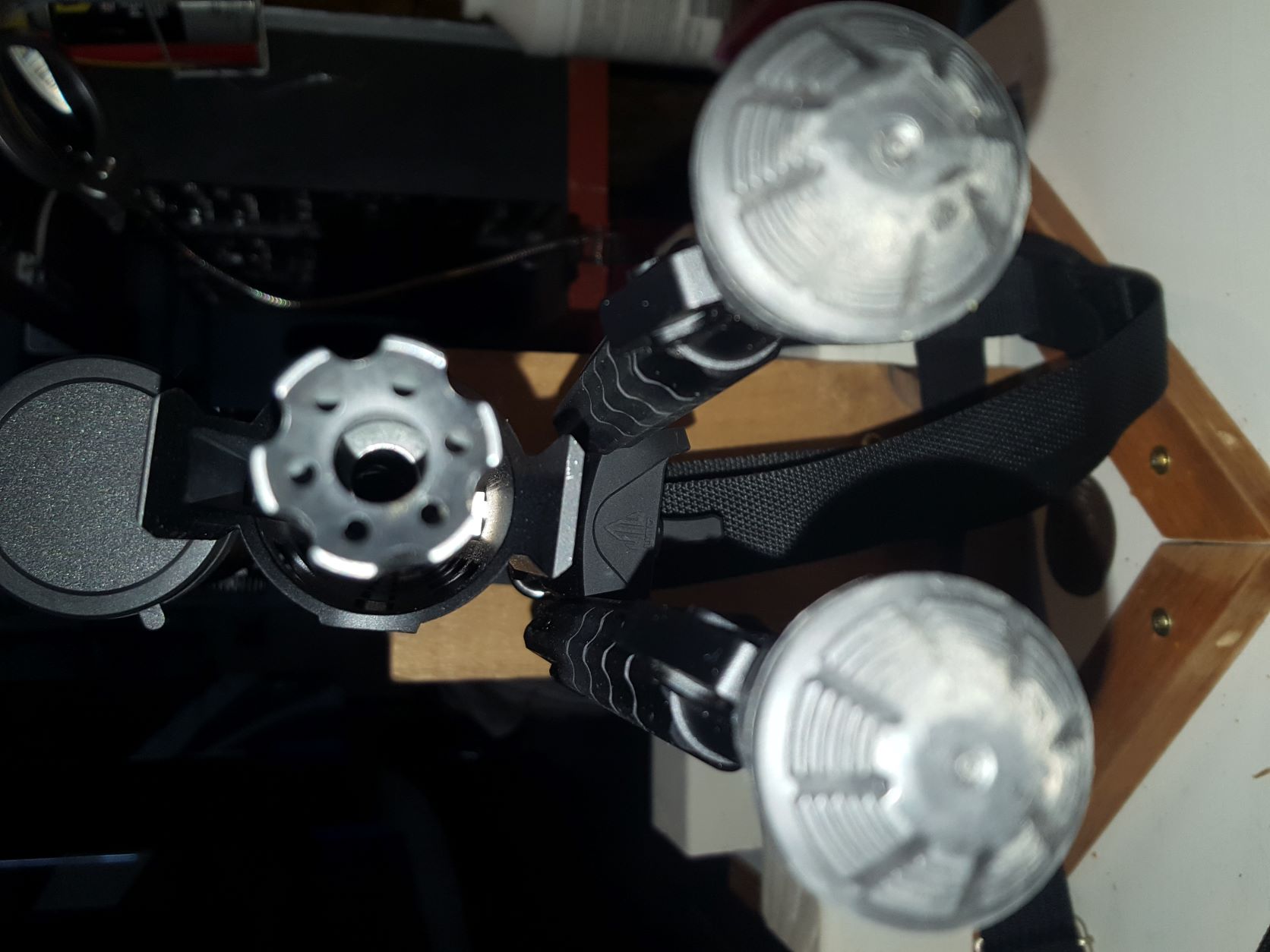

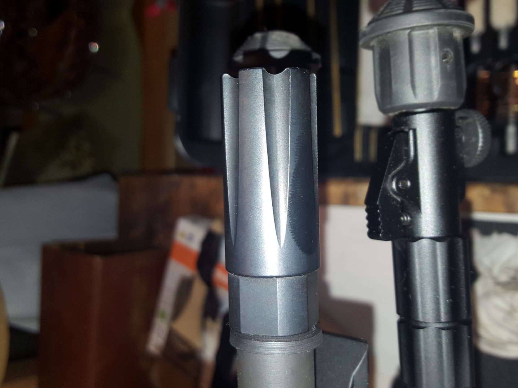

i never really thought much about flash suppressors , but here is mine on the 308 AR 10.
i choose this one as i do alot of prone shooting and it does not throw as much dirt up on each firing, bad thing is the kick is a bit more pronounced than using one with open sides
you guys have me thinking now to get another one for when i shoot from bench rest or kneeling
