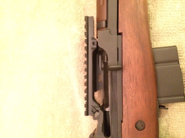

Update...
Progress on optics...
Sadlack Industries scope mount...

Very sweet! Looks like the old gal is going to get some eyes.RJGold wrote:Update...
Did you find the receiver and mount were a good fit? I was always reluctant to explore the dimensional quality of the receiver when I had the rifle.
Nice job! I look forward to seeing the scope and follow up with a range report.

The mount fit OK. The stripper clip mount and the dovetail didn't fit up exactly (The mounting screw wouldn't start cleanly with the mount secured to the receiver). Rather than do some metal work, I altered the mounting sequence and loosely started the dovetail mounting screw into the dovetail piece. I then secured the mount to the receiver and checked that the dovetail wasn't in a bind. It wasn't so I went on from there.
Next step is to find the optics, get them mounted and see how they do in terms of staying anchored and giving repeatable accuracy.
I'll keep you posted!!!
