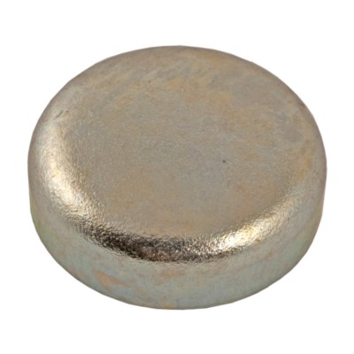

And here is the order of assembly, minus the baffles (freeze plugs) which I have not yet purchased, keeping in mind that the challenge coin will be inserted along the length of the spacer, about a 1/2" or so from the distal end of it.
These are the freeze plugs you need: http://www.napaonline.com/Catalog/Catal ... 0204530916
