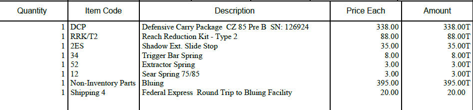

Soccerdad1995 wrote: Fri Jul 29, 2016 1:10 pm If you don't mind my asking, what work did you have done and what was the cost?
Just realized I never updated this thread with the answer to Soccerdad1995
$870 total not including return shipping ...thats more than I paid for it new in 1985 :mrgreen:
And still worth it to me when I :fire

flechero wrote: Thu Oct 18, 2018 10:16 am I loved the worn look, as I have grown to really appreciate honest wear. But the after pics are pretty awesome! :drool: Congrats again!
Late question, if I may... Curious as to why you chose the def. carry pkg and what it changed on a gun you carried for a long time? Assuming it was always reliable or you wouldn't have carried it?
This gun was stone reliable, for most of its life I tracked every round fired on a document the Army uses to track such things...(I was a unit armorer when I bought this gun in 85, and it was just fun to do at first along with a few hundred rifles, pistols and missile systems I was tracking anyway) I stopped tracking rounds fired in 2002, it had 10,100 rounds though it..not a single stoppage, failure to fire, failure to eject, ever.
It had a custom trigger, slide stop and hammer when it was sold new and the action crisp, clean and no over travel. I wanted that same thing but in new parts so we decided on the parts shown on the invoice.
