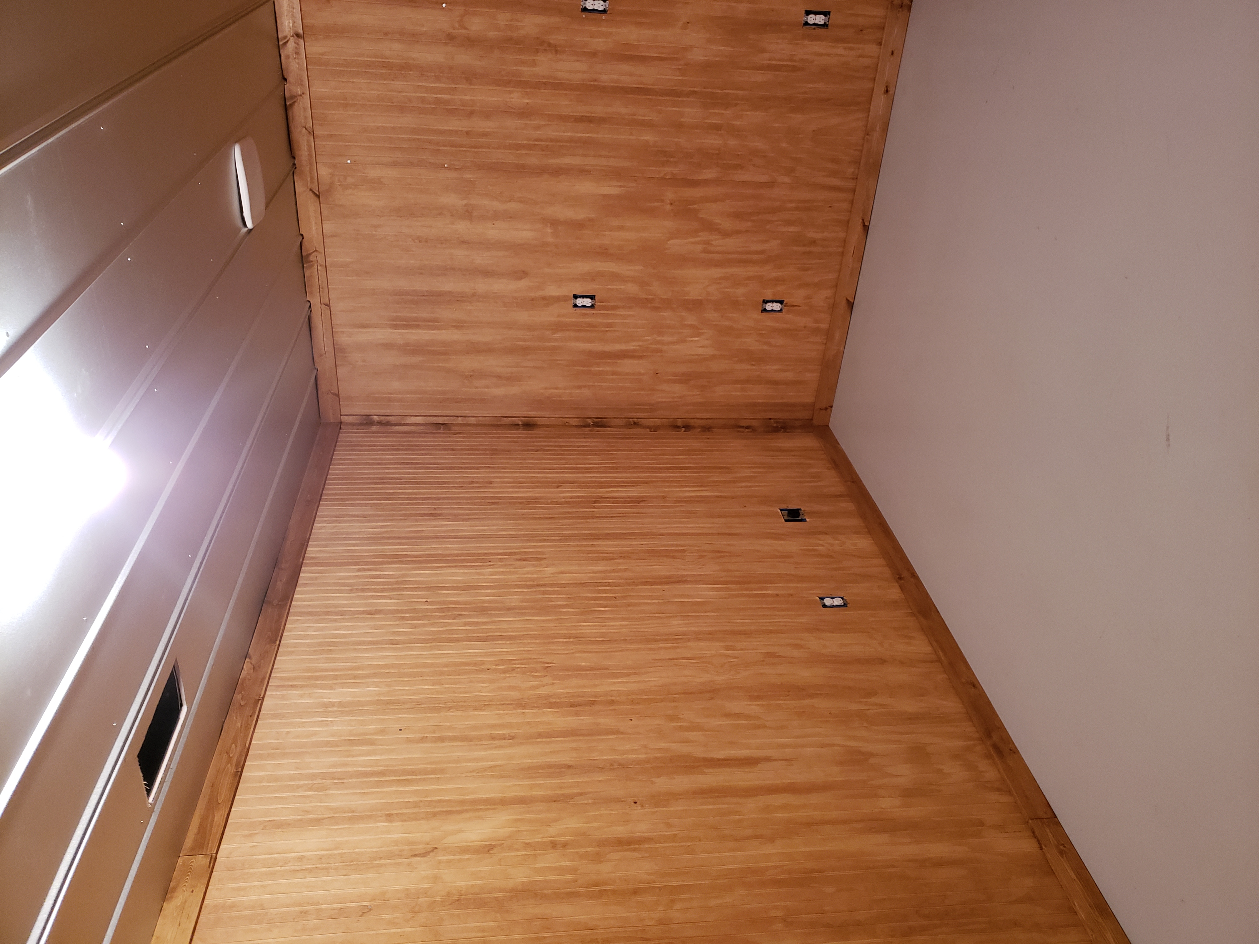

Tin on ceiling done. The shadows really exaggerate the waves and where the nails are. Going to try and get trim pre cut and stained tomorrow.
I am also surprised how dark the room got. I thought the metal would keep it bright. No big deal because I will have lights above work stations. It might get brighter with a ceiling fan with multiple lights instead of the single light in there just to build.

For the tin on the ceiling, I ripped the first panel down so the AC duct, smoke detector, ceiling fan, and exhaust fan cutouts did not hit a V.
All the trim is finished. The base boards and top are 1x4's. For the corners I ripped a 1x4 down to 2". What's left is close to 1.25". I didn't measure it but it's close enough that when you put the 2" in the corner, then the small strip in the corner against the 2" strip, they look the same width.
Only petily things left to do. Put another coat of stain on the steel door and leave the wipe marks on for texture. Stain the door frame. If I was thinking I wouldn't have gotten a primed frame but a raw wood framed door. Then there's the silly outlet covers, find some paint for the exhaust fan grill and a galvanized ac duct cover. Oh yeah, and build a reloading bench and desk.
Room is 15x8 ft. The floor is epoxied in a light grey (I forget the exact color name). There are 11 110V outlets and 2 220V outlets. The 110V on the same wall as the 220V are fed from the sub panel. As are the 220V outlets. The rear 4 outlets are on a separate breaker and the rest on another.
At the door looking diagonally across the room.

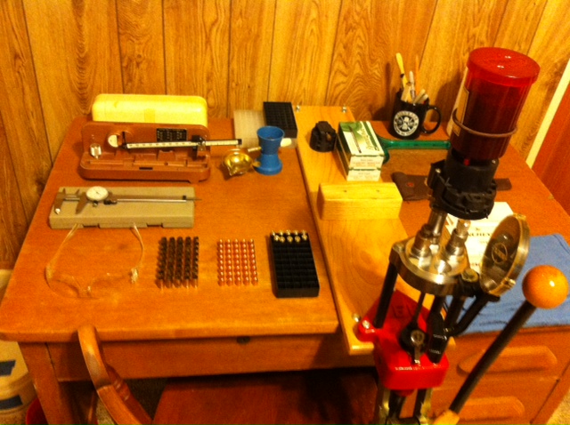

This was an Independence Day project that I'm finally posting.
While it isn't a real bench, and not nearly all of the accessories and supplies, this is my initial setup for handloading in an air conditioned space.
The board fits under the front of the desktop and clamps under the back of it with wingnuts, so it is fairly simple to remove the press for normal desk activities.

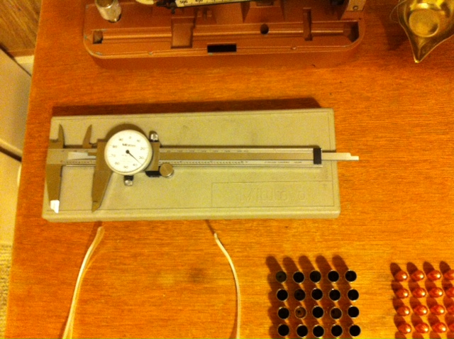

Matui vernier caliper came from my paternal grandpa and will always have a home here, but my eyes have an increasingly difficult time with the vernier scale.
Wanting to remain analog, I picked up a dial version from Ebay. Mitutoyo's in very nice condition - quick and easy to read.
