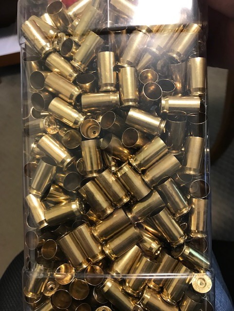

That's a deceiving statement and not completely accurate. Both processes uses car wax to preserve cleaned condition. I use AA Wash & Wax as my soap and add a dab to my rinse water. Here is a batch of brass, untouched for years... no fancy lighting, just a phone pic through the plastic bucket. It's not tarnished at all and still is like new. 2nd pic is new Starline brass for comparison. I have some brass that's 4-5 year old since cleaning with same or better appearance, just too lazy to go dig out for a pic for this post.
You can screw up either cleaning process if you do it wrong.
:tiphat:

flechero
Posts: 3486
Re: Article: What’s The Best Way To Clean Brass?
Post by flechero »
and new.....
