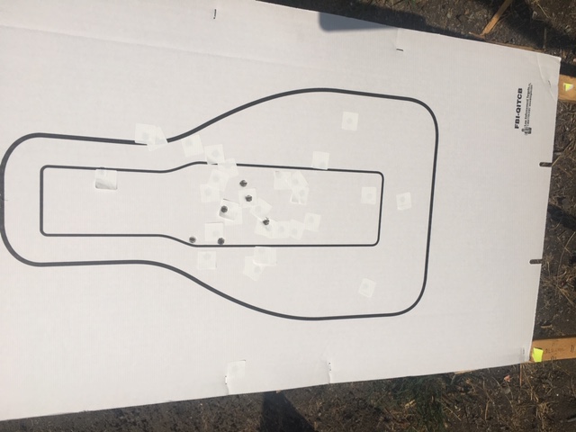

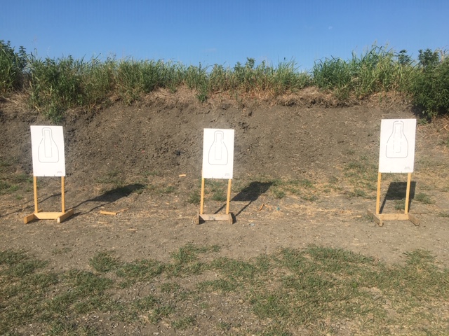

Paul Howe says if we mastered everything on the first try, we would find no joy in hard work and would soon become bored with this existence. If you agree the Federal Air Marshal (FAM) Qual is definitely for you!
Shot the FAM Qual live for the first time today with an M&P9 2.0 using a strong side IWB holster under a T-shirt. It should be shot cold, so that is what I did. However I didn't read anything about not being able to run it dry or not finding my NPOA first. I'd strongly recommend doing both.
Last time I ran the FBI Qual I scored 98/100. But the FAM Qual is much much more difficult. It takes more time as well.
Like the article says, Stage 1 is very difficult. I got a 3.23 sec score of 7 pts on the second try. Tried it few more times and could not beat that for accuracy within the time constraints.
Stage 2 isn't really a whole lot easier. Got a perfect 2.14 sec (20 pts) after a few tries. Balancing time and accuracy is a challenge here.
Stage 3 took me several tries to get a good score within the time constraint, but it felt good after I had begun to "warm up". My best was a 2.46 sec (30pts):
Stage 4 showed that I needed a little refresher work on my mag changes. The instructions don't really say if the reload should be under concealment or not. I ran it 6.32 sec (20pts) with the mags exposed. Need to run it from concealment next time.
Stage 5 took two tries. Yielding a 3.09 sec (20pts)
Stage 6 was the most difficult for me. Kind of a mini-El Prez. Unfortunately I haven't had a range to practice such things until recently, and although I could clean the targets, getting the time requirement didn't happen today. 3 yards between QIT-97 targets make getting the required accuracy more difficult than IPSC or IDPA targets
Stage 7 seemed like a snoozer compared to the others. Ran it a few times just to see If I could clean it under the time limits. I did with 7.18 sec (20pts).
I ran this qual with street wear. I'm certain it would be very helpful on Stages 1 & 6 to use a vest with an OWB holster or appendix carry.
Stage 7 has plenty of time to use sighted shooting, but generally I used point shooting for the other stages. Its difficult to consistently get the accuracy required (5's) with point shooting, but it can be done.
Cleaned some SF drills afterwards to sooth my ego! :biggrinjester:
My hats off to those who can shoot this qual cold all the way through without re-shoots. I'm not quite in that top 1% (yet). Look forward to trying it again next time. Let me know how your experience goes.
