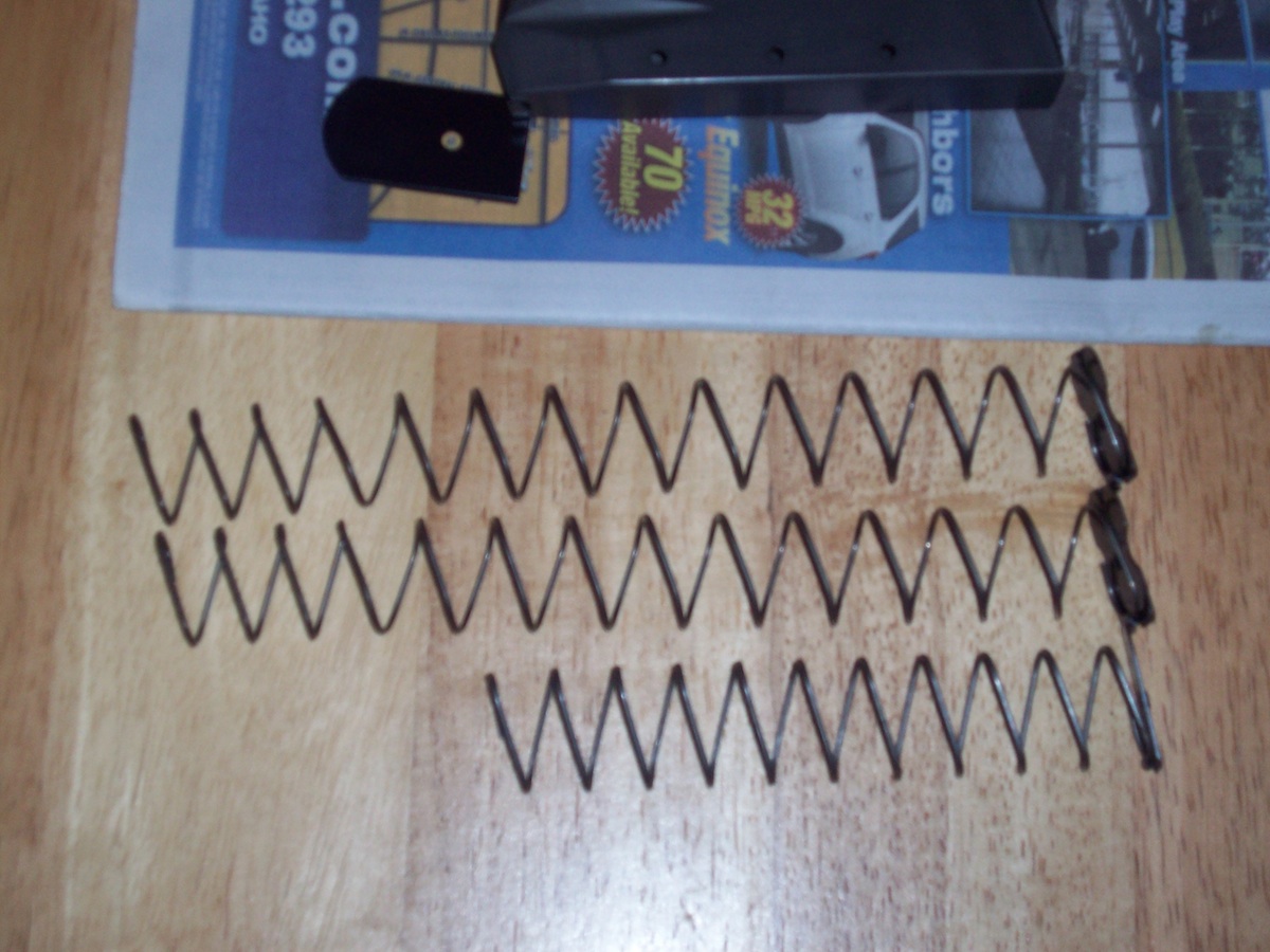

Also, I got two 15 round mags today that I ordered last week. The springs are much longer than the spring from the mag that came with the gun. I can load fifteen rounds in the new mags, but it's not easy. In fact it's damn hard. The new mags are Mec-Gar made in Italy. The mag that came with the gun has Sig Sauer P226 engraved on one side. I don't see any other markings on it. I assume it's the original mag that came with the gun. What explains the difference in spring length? Would it be safe to cut off an inch or so of the new mag springs? Or will they weaken with use? Is the old mag spring too weak? Is it safe to shoot with it?

It could be a worn out spring. It could be different manufacturers. What matters is if they work.baldeagle wrote:What explains the difference in spring length?
It's safe for the shooting range. Only use will show if it's reliable enough to bet your life on.baldeagle wrote:Is the old mag spring too weak? Is it safe to shoot with it?

My guess is that the barrel is well used. I would call it 2000+ rounds. Sig "smiles" on the barrel happen with use of the barrel, and your barrel has a pretty solid band of them. That being said, there's no reason to believe that the gun won't perform well, and at $350, it's a very good deal. You can probably get a slightly used Sig factory barrel for just about $125, or a Bar-sto barrel (not factory but a very good barrel maker for Sigs) for a little cheaper than that. The slide and frame seem to be very nice. Mec-Gar is a well-known manufacturer of Sig magazines and AFAIK are held in good regard. Some Sig models come from the factory with Mec-Gar magazines (the P226 Blackwater Tactical's 20-round magazines come to mind). I wouldn't think cutting a coil or two off the spring would cause that much trouble but I would first consider oiling the mag spring and breaking it in a bit. Just IMHO, YMMV, FWIW, and other acronyms, of course.

Don't cut the magazine springs. You'll risk having problems feeding the ammo, particularly as you get to the end of the magazine, or it could cause it to not slide lock when empty. New magazines are almost always difficult to load to capacity, but that will get better with use. If loading the magazine becomes a problem, you could try one of these: http://www.midwayusa.com/viewProduct/?p ... ber=952670" onclick="window.open(this.href);return false;

If you want to see a barrel with "smiles" on it, you should see mine...lol. Your barrel is fine. That is minimal wear. It will, in fact, wear more than that with use. I agree it's probably in the 1-2K rounds.
I have the Mec-gar 15 round mags for my P226 as well as the Sig factory mags (I read somewhere that Mec-gar makes the Sig factor mags as well). I never bothered to pull the springs, but I assume mine are the same. All of my Sig mags function flawlessly. If it works, don't mess with it.
ETA: The 15 round mags have an extended base plate. They are physically longer than the 10 round mags. This would require a longer spring.

I checked with Sig. The new Mec-Gar mags have "stronger" springs, according to their customer service rep, but the original mag should work fine. I counted the coils. The Mec-Gar mags have 13 coils whereas the original mag has 11. It's also compressed from use. I suspect the new mags will get easier to load with use, but I ordered the mag loader from Midway anyway.
