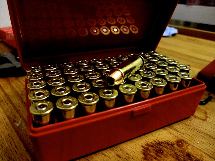

44 Magnum, Remington Brass, 200gr XTP, 16.4gr Blue dot, CCI 300 primer, 1.6" OAL., roll-crimped
Measured every powder charge just to make sure there will be no
I've saved about $15, only $500 something more to go to break even
Thanks! Too bad I can't join ya'll behind the sandbagsAndyC wrote:Congrats - and they look decent from what I can see, too!
Think of us when you drop the hammer on your first round - we'll be cheering you on (from way back yonder behind the sandbags)
Think "Lead bullets" - the .44 lurrrrves lead bullets7075-T7 wrote:I've saved about $15, only $500 something more to go to break even
Cowboy bullets are meant for low velocity, typically in the 750-800 fps kind of range. Usually uses a near-minimum charge. Meant only for putting holes in paper with minimum recoil.7075-T7 wrote:What kind of lead bullet is good for the .44? I'm kinda confused between the "cowboy" bullets and the "magnum" bullets and what velocities to drive them at/ how much and what kind of powder.
Boy, I hadn't even looked at the load.MoJo wrote:Seriously, you need to be behind the sandbags. Alliant's online data states for a 200 gr jacketed bullet 16.0 grains of Blue Dot is max!
I made them from the newest Hornady manual and used the 10% lower than max load they had listed. They're for target but I like recoil. The New Lyman manual lists 18.7gr as maximum and 15.7gr as starting with the 200gr Hornady XTP COL of 1.610". So I went for the middleJumping Frog wrote:Boy, I hadn't even looked at the load.MoJo wrote:Seriously, you need to be behind the sandbags. Alliant's online data states for a 200 gr jacketed bullet 16.0 grains of Blue Dot is max!
As mentioned, Alliant says 16.0 gr max, but that is for 200 gr Speer Mag JHP. That prompted me to pull my Hornady 6th Edition off the shelf and look. Hornady lists their 200 gr #44100 HP-XTP using Blue Dot as MIN=13.8 gr, MAX=17.1 gr.
I didn't bother checking my other manuals.
So you probably won't go Ka-Boom with 16.0, but I'd suggest starting lower and working your way up. What are these loads for? Target or Hunting? If they are target loads, there is no need to make them hot.
Sounds reasonable.7075-T7 wrote:I made them from the newest Hornady manual and used the 10% lower than max load they had listed. They're for target but I like recoil. The New Lyman manual lists 18.7gr as maximum and 15.7gr as starting with the 200gr Hornady XTP COL of 1.610". So I went for the middle![]()
I noticed that the hornady and Lyman manuals don't agree on a lot of powder, especially blue dot and H110.SeaHawk wrote:There seems to be a great deal of variation in data between loading manuals which makes me wonder if a more suitable powder should be selected.
you'll find that problem with a lot of powders and manuals.There seems to be a great deal of variation in data between loading manuals which makes me wonder if a more suitable powder should be selected.
