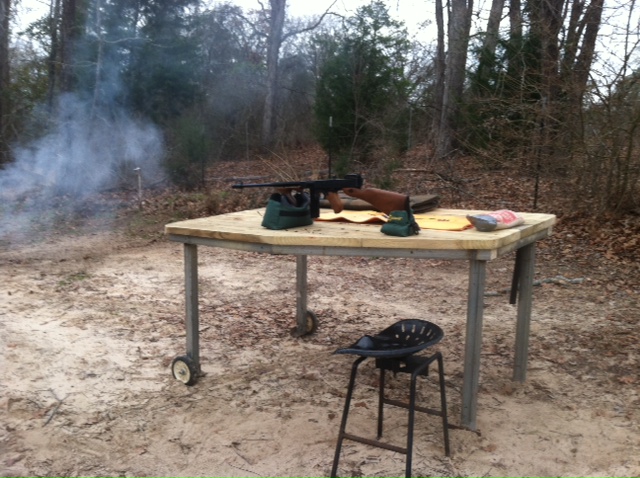

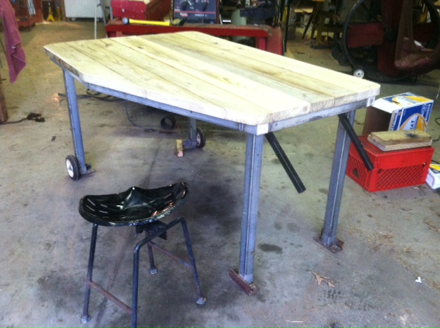

I had been needing a easily moved range table for years and when it was raining a couple of weeks ago, I spent quality time in the shop and built this. It uses scrap tubing out of my "spare parts repository" and I only had to buy one 2x8 CCA treated board. I used 2 old lawn mower wheels for the front and put a pivot on a piece of 1" tubing where you can swing 2 handles up in the rear and "wheelbarrow" it up and down the range. It will stand the weather fine. I built it with only a right hand angle, but today we mounted a couple of scopes and my wrong handed friend (left handed) just turned the table to the right angle. The stool is sucker rod, washers on bottom and is a cultivator seat off of a Minneapolis Moline implement and it swivels 360.
