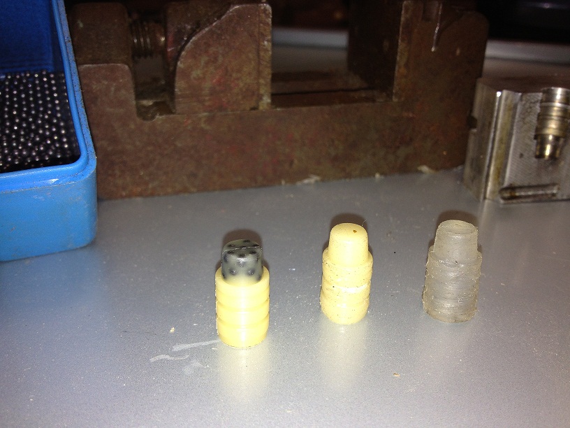

Left to right-->
38 swc Wax mix with #9 shot in top only mold bullet
38 swc wax mix only mold bullet
38 swc glue stick mold bullet
3 finished 38 swc Wax mix with #9 shot in top only mold bullet
More to come.

357 mag brass with primer pocket drilled out for 209 primer.
209 primer inserted into the 357 mag brass... NOTE..I made these like the ones commercially available to where the primers are pressed in with your fingers, not a press. Works great and they have not tried to back out yet.
The wax bullet with #9 shot weighs 30 gns.
The one that is just a wax bullet weighs 13 gns.
The glue stick bullet weighs 13 gns also.
The last one with shot I shot at a box about 15 feet from me went through both sides of the box and was lost..!!!
Others I recovered inside box with a towel in it, were able to be reloaded several times before it "Gave Out " ;-)
Just thought I'd show a few pics of my project.
So far...I really like the wax bullets with the #9 shot. :hurry:
