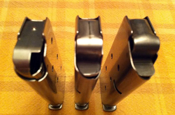

What does your magazine look like? P238s were having all sorts of problems that all traced back to the magazine they were shipped with. If it's brand new you should have the latest but you never know. If it looks similar to the Colt Mustang magazine then I bet Sig won't ship you back that one. The new ones have a rounded out follower.

He should have the newest magazine, but it would be good to check. Here's a picture of the three magazine generations - the one on the left is the latest. I had zero luck trying to use an extended Colt Mustang style magazine.

I do indeed have the latest gen. mag.
