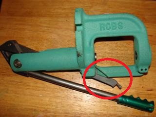

A friend of mine has an RCBS press with a missing part. His father in law gave it to him since he has switched over to progressive. My friend doesn't need it and he doesn't want to spend any time trying to hunt down the part to get it working, so he is going to give it to me for free. I do not have possession of it yet, but he sent me the picture of what it looks like online and what part is missing. he said it is the part that presses in the primer?

I have attached the picture that shows what is missing circled in red. My question is, can it be replaced? How much is this part and can I buy it from RCBS or some place online that sells it? Is that part it worth replacing?

The primer arm is a commonly damaged/lost part so replacements are available both locally and online. Try Midway, Grafs, or Brownells. You might also find one on Amazon. Online they sell for about 15 bucks + shipping. If you find one in your LGS for $20 + tax you are in the right price range.

Sounds good. Any specific one to get or are they all the same? I am not sure what the model for the press is so I don't want to order the one for the wrong model. Thanks everyone!

From http://www.rcbs.com/downloads/parts_book.pdf it looks like a Reloader Special or RockChucker Jr.

It's usually lost because it's only held in by a easily pressed out pin.
OR, like I did, I took it off because I never used it. I've used the RCBS bench primer tool.
I still have my old one like that, I think it's a RCBS Jr. press.
Could also be a RS press. ( Reloader Special ) both use same primer arm.
It's a good press, not quite as strong as the Rockchucker, but will do anything you want to do....
Also, there is a top piece that screws on that holds the primer tube( which you need too ) with the two set screws at top of press. You will need all 3 parts I guess? They are not expensive.

On my Single stage press I simply choose to hand prime. Find out the model of your friends and if it's the same as mine I will gladly mail the never used parts off mine if I can find them. There has been some revisions in the primer arm system between RCBS Rock Chuckers if I am not mistaken, but I am willing to bet that RCBS will send you the parts at no cost.
After I clicked submit I realized I knew where the primer arm was, went and checked so now it's on my desk. My press is a Rock Chucker IV, if it's OE arm will fit yours then you can have it. I do not have the auto prime system as I never purchased that seeing how I prefer to hand prime when using my single stage rig. Another worthwhile upgrade is to install the Hornady L-N-L bushing kit.

It is a RCBS Jr Press. I still have the one that I bought in 1974 and use it occasionally. While not as robust as the Rockchucker, it will probably do all you want. I used my press to make to turn 30-06 brass into 270 brass then back to 30-06 for my metallurgy project on the effects of cold working 70-30 cartridge brass while going through mechanical engineering. Times sure were different in the 70's at a small school in north Louisiana.

I forgot to mention that the picture I posted isn't the actual press I am getting. He just showed me the press just so that I know what part was missing from the one he is giving me...
