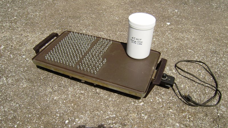

Speaking of how to heat up things related to reloading I'd like to make a suggestion: go to Good Will and buy an old electric skillet for $5 to $10. Here's a picture of the one I bought a couple of years ago drying some 45 ACP 200gn LSWC's I lubed with Lee Liquid Alox.
click on picture to enlarge it so you can see the detail
These didn't line up quite as nice as V-ROG's do and they forgot their guidons but they are just as ready to go after a night of drying on the hot plate. ;-) (Most were already in the canister before I realized I needed to take a picture to show you guys.)
Anyway, the electric skillet in the picture is the one I paid $10 for. It has a continuously variable thermostat that runs from just warm at 150 degrees on up to 450 degrees which is suitable for annealing boolits if you need to do that. It's also good for drying microscope slides if you're into microscopy.
I have another regular "hot plate" that looks like a single burner from an old electric range but was made with just one coil and a thermostatic control. Got that one for $5.00 because it had an incredible amount of food burned on it. A little Simple Green cleaner and elbow grease got it down to bare metal in quick time. I use that one to pre-heat my moulds and keep them warm when I have to set them down to add more metal to the melting furnace.
It's amazing how much stuff you can get at Good Will and resale shops to use in reloading / boolet casting. :thumbs2:
