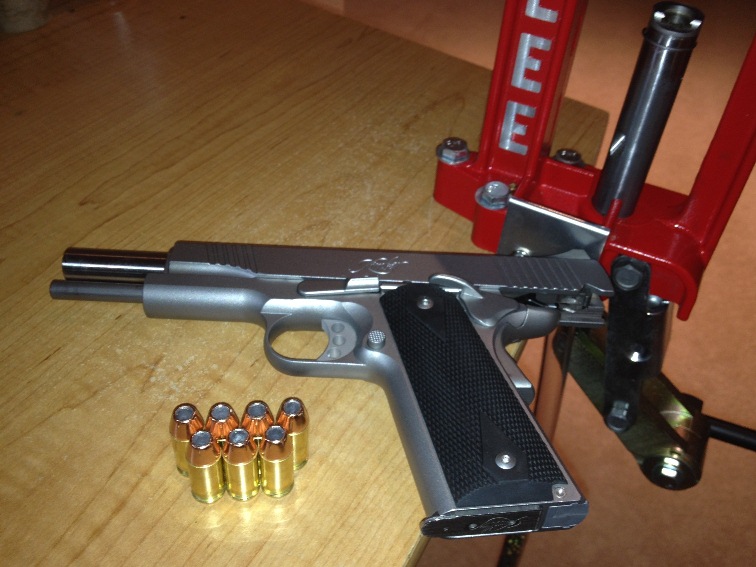

Thanks to several on this forum for guidance when I first got started a few months ago. I bought the Lee Anniversary single stage press to start reloading .30-06 for my M1 Garand. Have loaded quite a few rounds for it, got over the initial jitters about shooting my own reloads, and really enjoy the new hobby (knew better than trying to cost justify, so it is a hobby from the get go...)
Just moved to .45acp and having good luck with my first batch of 100. Using Hornady XTP 230 grain JHP rounds, my own once-fired brass, CCI large pistol primers, and 3.5 grains of Clays powder. Very happy with the results so far at the range with my new 1911!

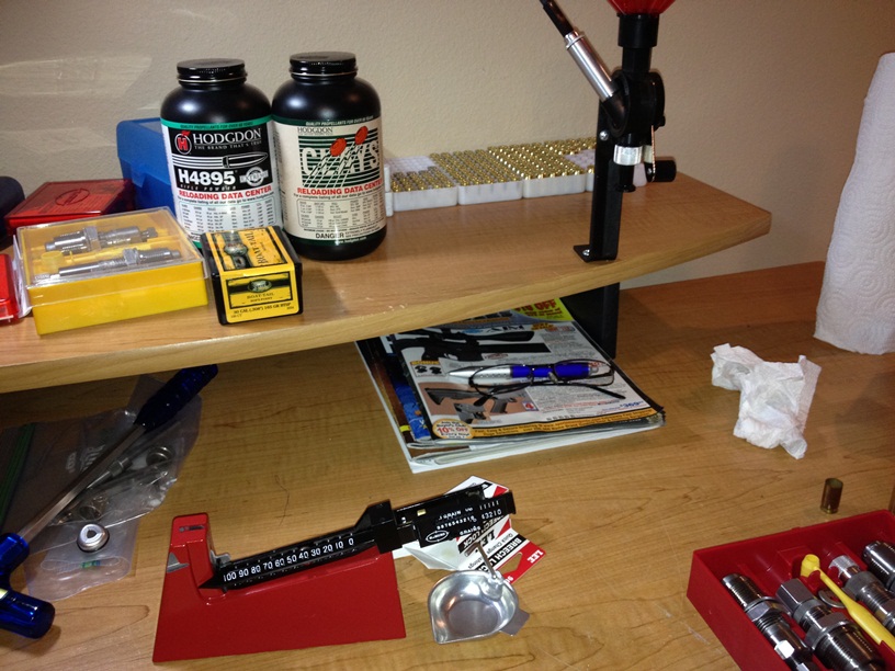

You'll enjoy it DocV! While I can never cost justify (saving money vs. buying commercial), it can be done on a budget. I absconded with my kid's rock tumbler and bought some lizard litter at the pet store for media (ground walnut shells). Took over an old homework desk for my bench. I've got a less expensive press than the Rock Chucker, but with dies, etc. for .30-06 and .45 acp I've got about $240 in hardware for everything.
I save the plastic trays out of old commercial ammo boxes for trays and they work fine for what I'm doing to keep things organized.

That is a good setup. I have a project bench from Home Depot that I plan to use. I have been keeping the ammo boxes and spent brass for quite some time. I bought some lizard bedding and have a cheap tumbler. So far I have tumbled 500 cases - all large primer, once fired brass. I still need a scale, powder measure, bullet puller, etc. I plan to buy a Lee taper & crimp die and a Wilson, or Dillon, case gauge. The list goes on and on... :)

In your picture you have an impact bullet puller that is very similar to the ones I use. A little trick I use is that I will pull my shell holder off the press and use it to hold the cartridge in the puller rather than fight with making those stupid collets work.
