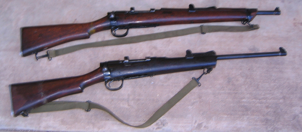

I own a couple of Ish's & 4 .303 Enfields myself--(2 #4's (1 Standard, 1 Sporter) #1 SMLE, #3 Jungle Carbine) all of them shooters. I have redone the stocks on my #4's and scoped my Sporter out, have ended the life of many hogs with her.
