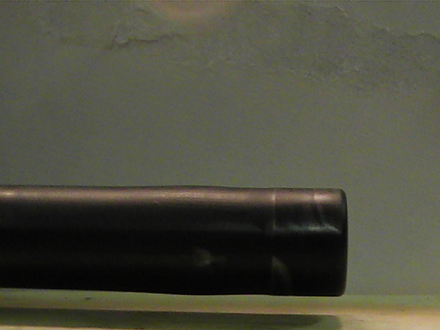

let me add a OMG moment with my first run of cast lead bullets
I SCREWED up the powder load and squibbed a bullet and before the brain connected the BULLET didn't hit the berm, i fired again and bulged my xd barrel to the point that it jammed the slide and cost me 125 to get her fixed at Springfield with a new barrel, i normally shoot at the targets, but this day there were enough black cats crossing my path i should have stayed home
I ran 10 rounds to check for feed and feel, so i aimed at eh berm at the range vice wasting a target
guy next to me was shooting a HOWITZER and i paid more attention to its horrific noise than the noise from my firearm,
our range had just installed a roof over the firing line and the noise reverbs were not set in my brain yet
