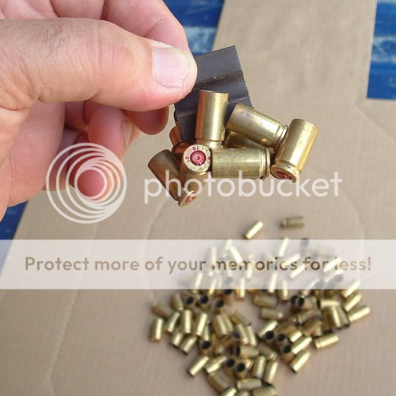

To those of you who reload and collect range brass. There is some 9MM S&B "brass" that isn't brass it is STEEL with a coating of brass over it. I gathered a bunch of it Saturday only to discover it is attracted to a magnet when I was sorting my .45 from my 9mm. The cases in question look just like boxer primed brass cases but, they aren't the headstamp is "S&B 9X19 09". Be aware and if in doubt check it out! You can ruin a set of dies (least bad) or blow up your gun (most bad) reloading steel cases.

The magnet knows.

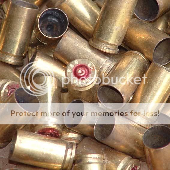

The dirty "brass" before cleaning.

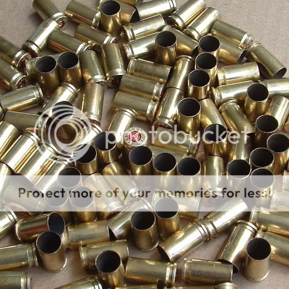

All shiny and clean.

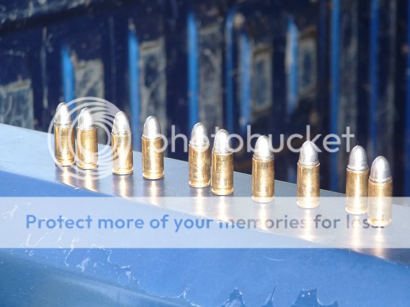

Ten little bullets all ready to shoot.
I used a home cast Lee 124 gr tumble lube bullet, Federal primer and, 3.5 gr Titegroup.
