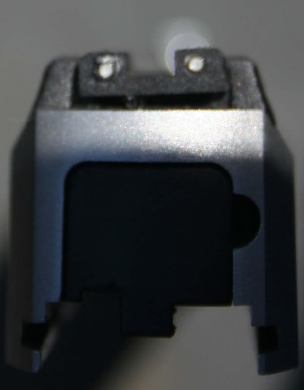

Here are some pictures for the sights. The work is still going on, but mainly that will be touch up, clean up, and re-align (at the range) . Hopefully that should be it.
Anyway..... This is the rear sight.
As you can see it needs a little touch up work and to be slightly realigned.

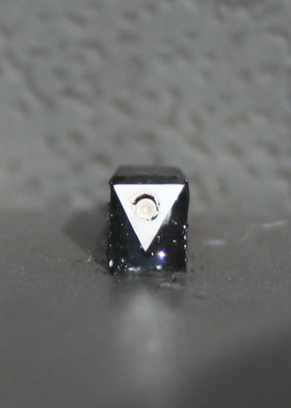

The front sight.
I added the white triangle to make the front sight easier to see in the daylight. That tritium dot was just way too small for my old eyes :mrgreen:
Again a little bit of touch up and clean up required but I have to wait until the Norland 16 is fully set (3 days is recommended)

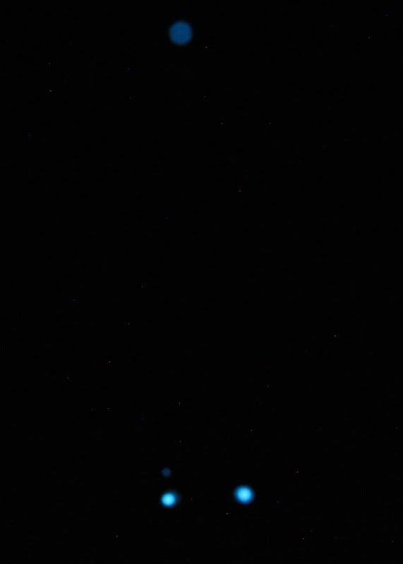

And finally.....how they look at night. :thumbs2:
