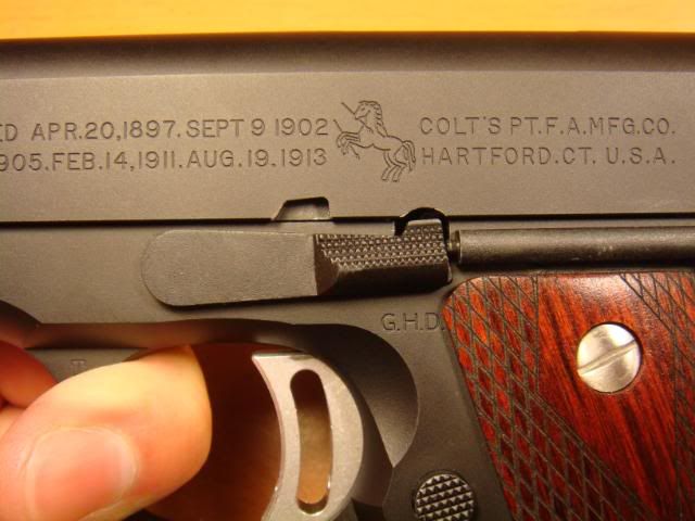

Sometime the alignment of the notch in the slide with the tab on the slide lock pin is non-intuitive. It's not enough to just align the notch with the grooved finger-pad. you have to align the crescent-shaped inner cutout with the corresponding tab on the inside edge of that extension.
Once spring pressure is off by pulling the front plug, you should be able to move the slide back and forth about 1/8" while pushing lightly on the pin from the other side. It also helps to push up lightly on the slide lock, because at it's lowest point it has a lip that catches behind the edge of the frame.
So, with your left hand you are gripping the muzzle end of the slide and frame, and adjusting the fore-aft position slightly as you feel for the notch with your other hand
With your right middle finger you are pushing on the pin from the back side.
With your right thumb you are pushing up on the slide lock.
You will be able to feel it when you hit the "sweet spot" and the pin will come right out.
On new pistols it can be a bit stiff, even more so going back in. I had to file the one on my SA Gi stainless before it would behave.
