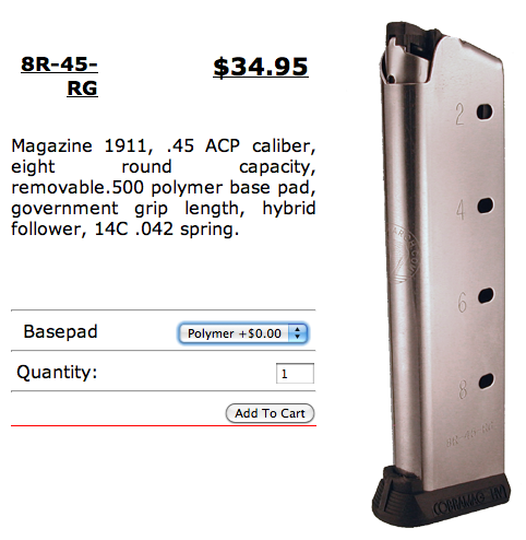

Re: Question about the Chip McCormick Power Mag 8 rd.
Tripp Research Cobra Mags: http://www.trippresearch.com/store/store_1911.html
Unquestioningly the best 1911 magazines I've ever seen or used. They are all I will buy now. Yes, they cost more; but they are worth the price. What's your life worth?
Also, Tripp Research sells all the parts for their magazines, so you can maintain them on your own if you want. Or, if you just wanted to use their parts to rebuild your own mags, you probably could. Their "hybrid follower" is the heart of the beast.
I have never experienced a magazine related problem with any of my 1911s since I started using Cobra Mags. A few years ago, I bought some Chip McCormick magazines, and they never worked as advertised. It didn't matter if the pistol was a Kimber, a Taurus, or an old 1943 vintage Ithaca. I was not impressed with that product.
