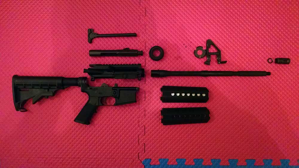

It's a Del Ton upper kit on an SAA lower. Had a blast putting it together and have been pleased with how it runs. Of course, it's in pieces because the second stage of the madness has set in, "what can I do to it now?" My wallet realizes this is a dangerous phase.

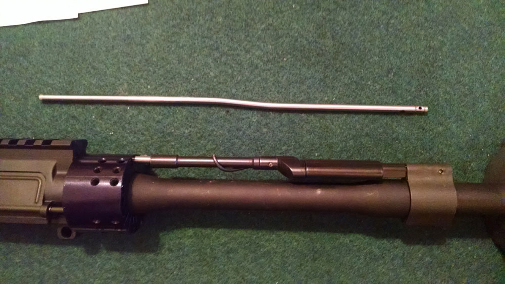

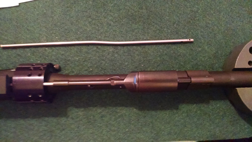

Removing the bleeping A2 sight tower so I can put on a free floating guard and low profile gas block was as difficult as advertised. A medium sized sledge hammer, a quality tapered pin punch, and about eight mins of frustration got the pins out.
Don't have the new guard in hand. I screwed myself by installing an Osprey gas piston kit (it was laying around)--it severely limits the guard options--and I'm too stubborn to convert it back.

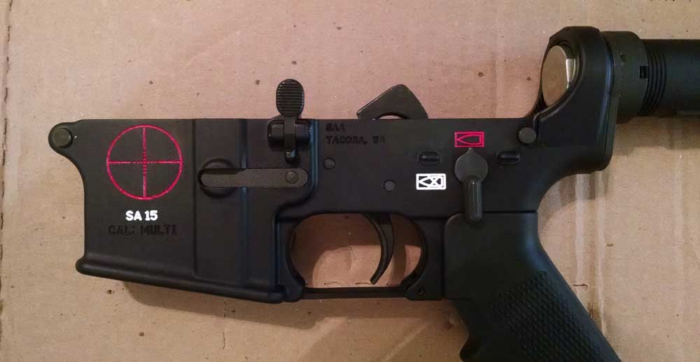

Tried my hand at a little arts & crafts project. Used some Testors enamel paint and only had to redo my work once.
(the red needs to be color adjusted in the photo, it's much brighter than it appears)
Overall, I like the results. There's still a little cleanup with a q-tip to do, but I'd do it again I think.
If you want to experiment yourself, there are some decent instructional videos on youtube. Keywords, AR Color Fill or Slide Color Fill. Pistol shooters have been doing this for a long time, but I'd never taken the plunge.
I found using some fine weave scrap cloth worked much better than paper towel for picking up the excess paint. It's smoother and doesn't grab the softened paint as aggressively. I let my paint dry overnight before removing the excess.

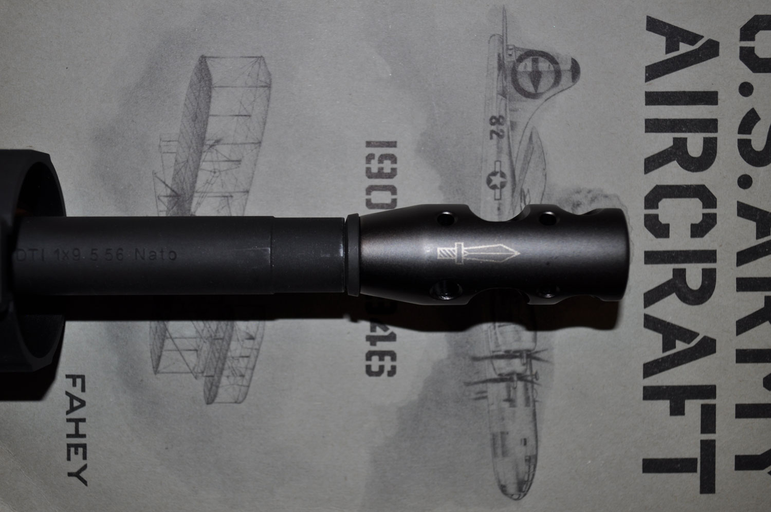

Dad, "Hey, want a compensator for that thing? I've got a little box of 'em."
Me, "...inarticulate babbling...." Opens box. Out fall two low profile gas blocks (I'd just bought one) and a handful of sweet compensators.
Took off the A2 Birdcage and added this fine looking example. Can't wait to try it out.

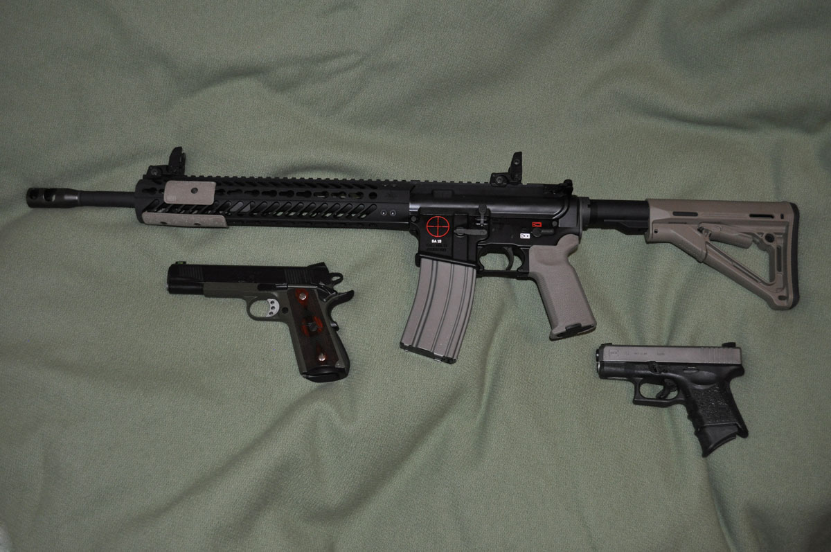

Got the Magpul buttstock and pistol grip added. Went with 'flat dark earth' color mostly to differentiate this rifle from anything else in the safe. I ordered a pack of the guard grip sections in three different lengths. Should have ordered three of the longer ones. The panel sections are thin and I am wondering how they'll hold up to heat.
The buttstock is definitely worth the upgrade.
Although I'll probably add a bigger charging handle and change out the trigger guard, I think I can call this build/rebuild done.
Now I need to restock the gun fund and buy the optic ;-)
