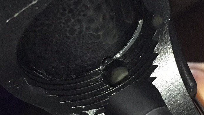

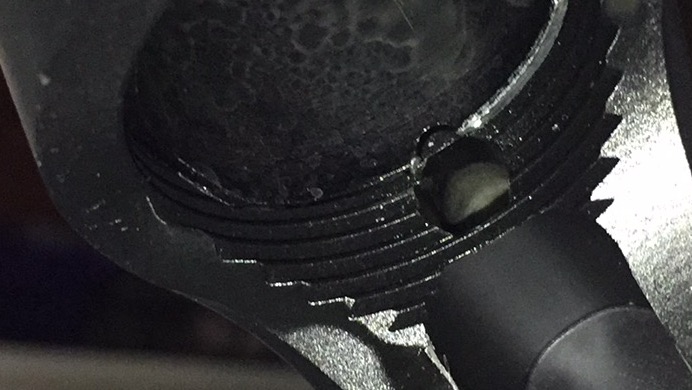

Here are pictures as it sets. The more I look at it the more I think Andy may have a good point. It looks like the tube could have had one more twist in. This is factory so maybe this one they overlooked. I will try and get a photo of the bent buffer retainer.

From the pictures I'd say that buffer tube needs one more turn to really capture the retainer. As it sits it had almost no lip for the retainer to be trapped under; probably the reason it broke it off. To Andy's point when the rifle is closed there should be nowhere for the retainer to go.
To others points i don't know if I'd be able to trust the replacement part that DPMS sends/uses to repair this.

That's exactly the problem. You know, my son could have fixed this in about 5 minutes for you. :mrgreen:
You can send it to the factory if you want, but it really isn't necessary. If you have the missing retaining parts, take the buttstock off of the buffer tube, loosen the castle nut a few turns, thread the buffer tube in another turn (or two, if necessary), replace the buffer retainer, tighten the castle nut back down and stake it, remount the buttstock.
End of problem. But The Annoyed Boy could fix it for you EASY.
What he said. The buffer tube should screw in all the way until it retains the spring pin. Stake the castle nut. So the buffer tube was not screwed in all the way and therefore the pin was not captured. But it did not "break thru" the buffer tube. There is an "on -purpose" recess there in order to catch the outer lip of the spring pin. Here is my S&W AR-10:

Should I replace the buffer tube?

carlson1 wrote:Should I replace the buffer tube?
I don't think so unless there is some problem with it that caused an interference and therefore prohibited it from seating all the way to begin with. Try screwing it in and see if it retains the spring pin. Might just have been a manufacturing oversight. But if the spring pin (buffer retainer) is bent, you obviously will need to replace that. Pretty minor.
The buffer retainer definitely has to be replaced. It is bent so bad that it will not even fit in the hole anymore.

$0.98 at Brownells: http://www.brownells.com/rifle-parts/re ... 17559.aspx
If you need the spring, that's another $0.95 at Brownells: http://www.brownells.com/rifle-parts/re ... 17560.aspx
