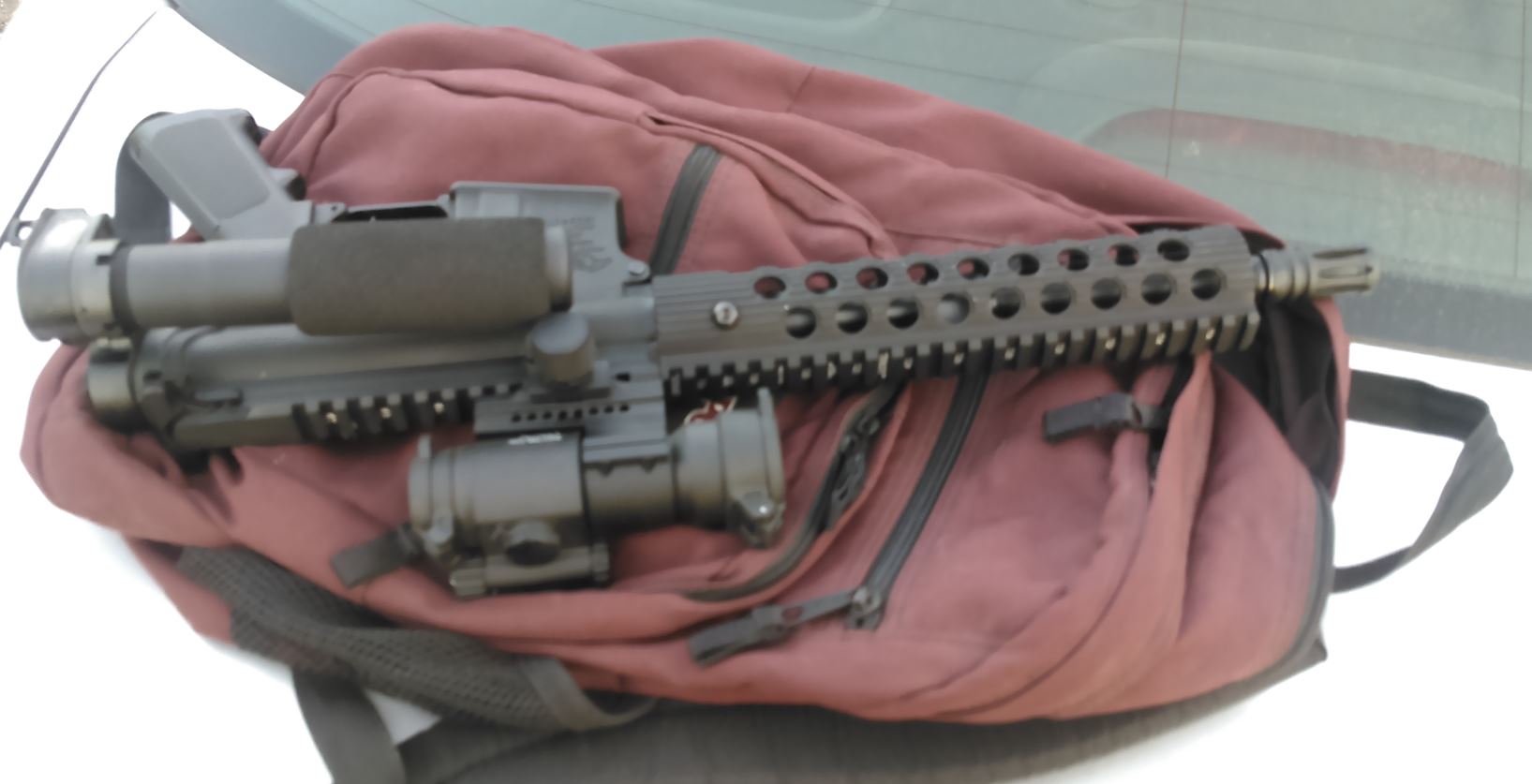

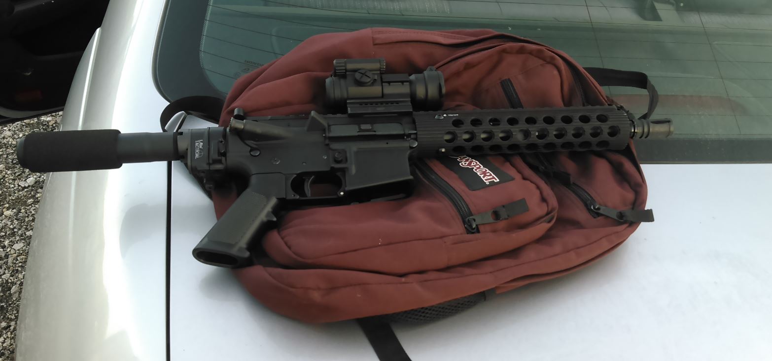

After almost 6 months of research and buying parts, I finally built my AR Pistol. I had a little bit of light left on Friday after putting it together so it only got to shoot 10 rounds, which went off with no problems. Hopefully this weekend, I will get it cleaned and sighted in.
Only thing left to buy are back up sights and possibly a slightly larger backpack.
Build list:
Anderson stripped upper & lower
All Anderson parts except for the following
Upper:
Ballistic Advantage BA Hanson 10.3" 300 Blackout Barrel w/ pinned low profile gas block
Ballistic Advantage Melonite coated gas tube
Fail Zero M16 Bolt Carrier Group
A2 Flash Hider
Troy 9" Alpha Rail
Aimpoint PRO Red Dot
Lower:
Hiperfire EDT 3 Trigger
Law Tactical Gen 3 Folding Buffer Tube Adapter
Picture is from the cell phone, sorry.
Build list:
Upper:
A2 Flash Hider
Troy 9" Alpha Rail
Lower:

What happens if someone mistakenly fires it while the buffer is folded? Is the bolt retained somehow, or does it come flying out to embed in the shooter's face?jason812 wrote:There's an AR pistol in the picture, it's just concealed.

Pawpaw, the answer to your question is in blue.
Thanks. I am not disappointed one bit with any part of it.Pawpaw wrote:What happens if someone mistakenly fires it while the buffer is folded? Is the bolt retained somehow, or does it come flying out to embed in the shooter's face?jason812 wrote:There's an AR pistol in the picture, it's just concealed.
I was wondering how long I should wait until I posted these but I guess I will let the cat out the bag.
There is an extension that pushes into the end of the bolt carrier to take up the space of the hinge. When the buffer is folded, there is a tool steel latch that blocks the travel of the bolt. Supposedly all you have to do is close the buffer and cycle the bolt to extract the shell. I would rather not try and will keep it with the mag loaded but chamber empty just to be on the safe side.
When the buffer is closed, the latch is out of the way allowing the bolt to function like normal. You have to push the latch to get the extension in and out of the bolt and it has to be removed before you separate the upper from the lower.

I got the folding adapter from Brownells as it was the cheapest place I could find that had it in stock. Also, for those wondering, yes it is inside the backpack in the first post, not underneath. I need to make a foam insert to distribute the weight from the tip of the barrel, keep it from being loose inside, and protect the gun. I probably will need a bigger pack but it will fit in one that doesn't look "tactical".
In case anybody is wondering the overall length not counting the flash hider is right at 26". Folded is 20.25" long counting the flash hider and about 5" wide where the buffer overlaps the upper receiver. The hinge ads 1.5" to the buffer tube length.

I have read reviews of this product which were generally favorable, but MOST STRONGLY recommended against firing with the stock folded. The retainer thingie which locks the BCG extension in place is possibly not strong enough to stop the rearward travel of the BCG under recoil, and could be either bent, rendering it inoperable, or broken off. I like this adapter a lot, and while I think it is overpriced, I will probably pick one up some day. But I will NOT be trying to fire it when folded. I don't think it's a very good idea.Pawpaw wrote:What happens if someone mistakenly fires it while the buffer is folded? Is the bolt retained somehow, or does it come flying out to embed in the shooter's face?jason812 wrote:There's an AR pistol in the picture, it's just concealed.
EDIT: I forgot to mention that is very nice and I like it a lot!
https://www.youtube.com/watch?v=_3rab8d5fHU
Edited to add: You can see in the video above that the tab that sticks up to retain the BCG extension is this a thin piece of steel. It is only designed to retain the BCG, and I would not only think it easily damaged under a firing impulse, but probably dangerous to do so. In fact, at minute 13:20, the ITS Tactical reviewer specifically mentions not to fire. And at 17:55 he actually tries it and gets away with it, but then at 19:15, he shows you what damage that did to the system. So........a singularly bad idea!
