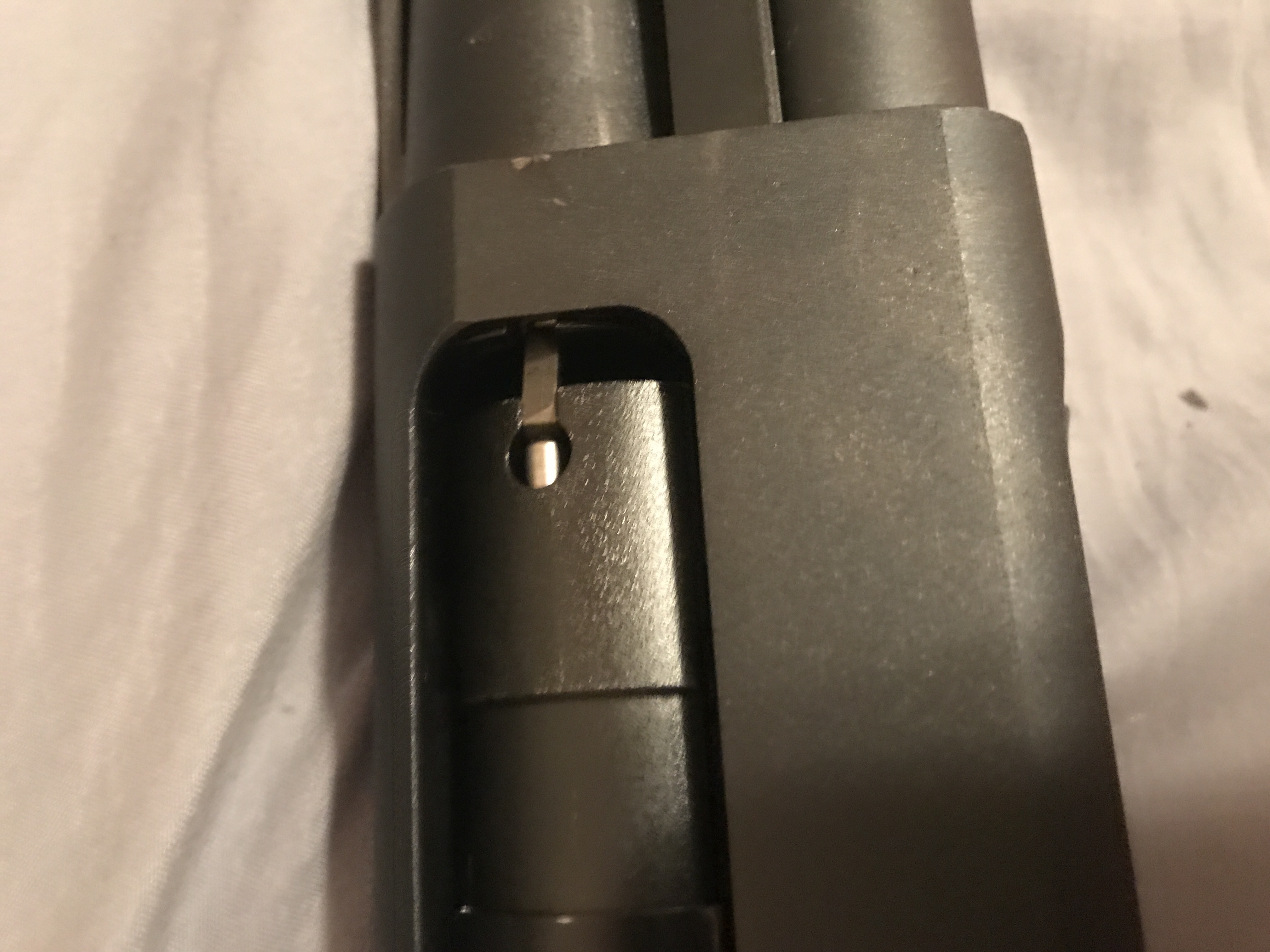

I have a Remington 870 super mag that is not fully locking up when you cock it unless you slam it way harder than I believe you should need to it looks like the extractor is not moving easily enough. Do I need a new extractor?

Sounds like something is obstructing the spring or plunger have you taken it out and cleaned it? I have seen this happen before from that. Does it move freely? Feel gritty?
I am sure you have checked all of these things but just incase....

Had this problem with my 870. I took it apart and deep cleaned it and snuffed the forend nut down. That fixed it for me.

There are many google posts if you type
remington 870 not going into battery
tube nut being loose seems big

After looking at your replies and seeing if it does it with a shell I think it’s the extractor. Thanks!

Clean the extractor area well. :tiphat:

I just got my replacement extractor from Volquartsen in and it fixed the problem thanks everyone!
