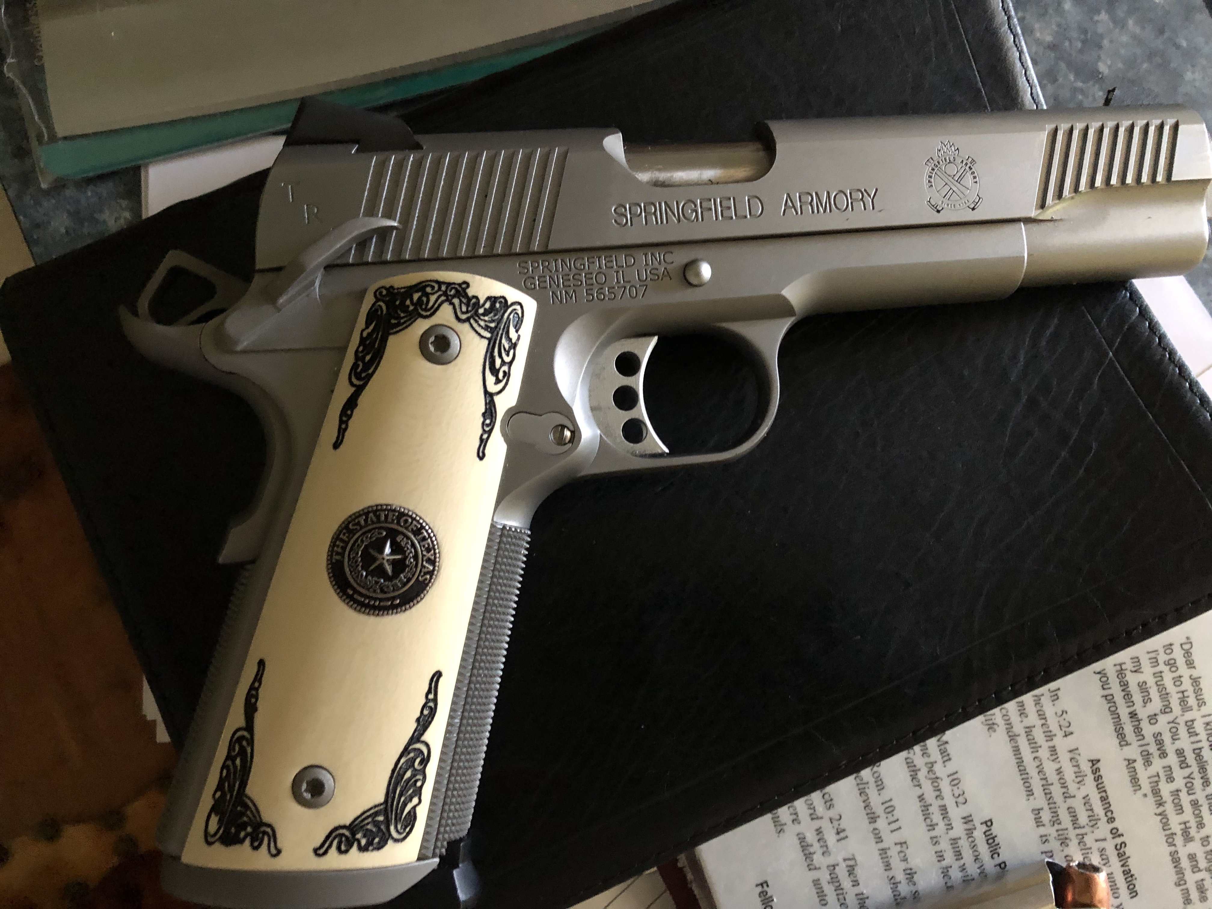

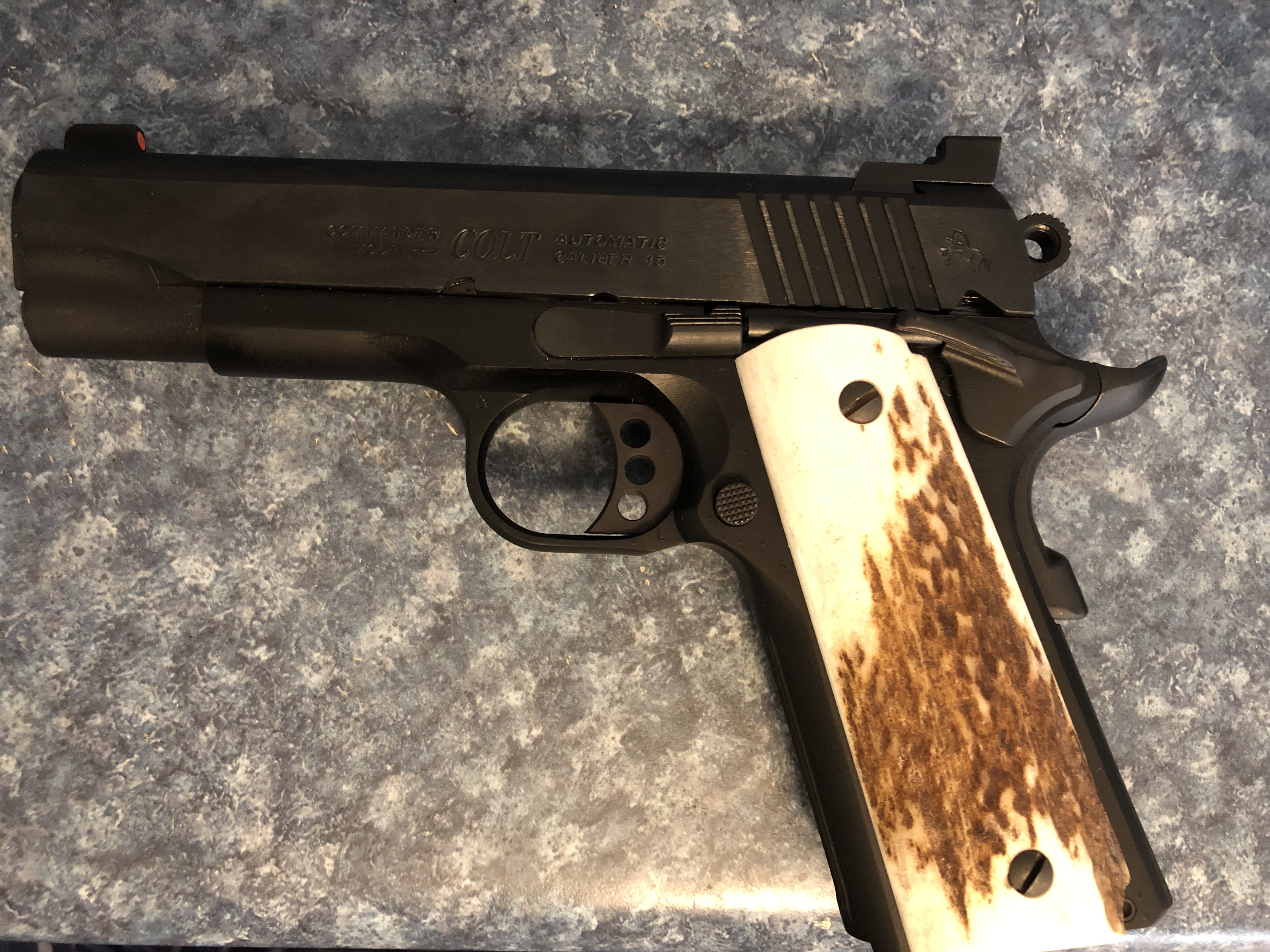

Thanks for the help. When I ready Andy’s post I remember having the O’ rings from the past. Going through my 1911 box I found them. I hope this solves the problem.
- carlson1
- Moderator
- Posts: 11913
Re: Problem With 1911 Grip Screws
I have no ideal when I bought these O’ rings, but I am glad I kept them. Input them on my Commander and on my TRP just in case.
