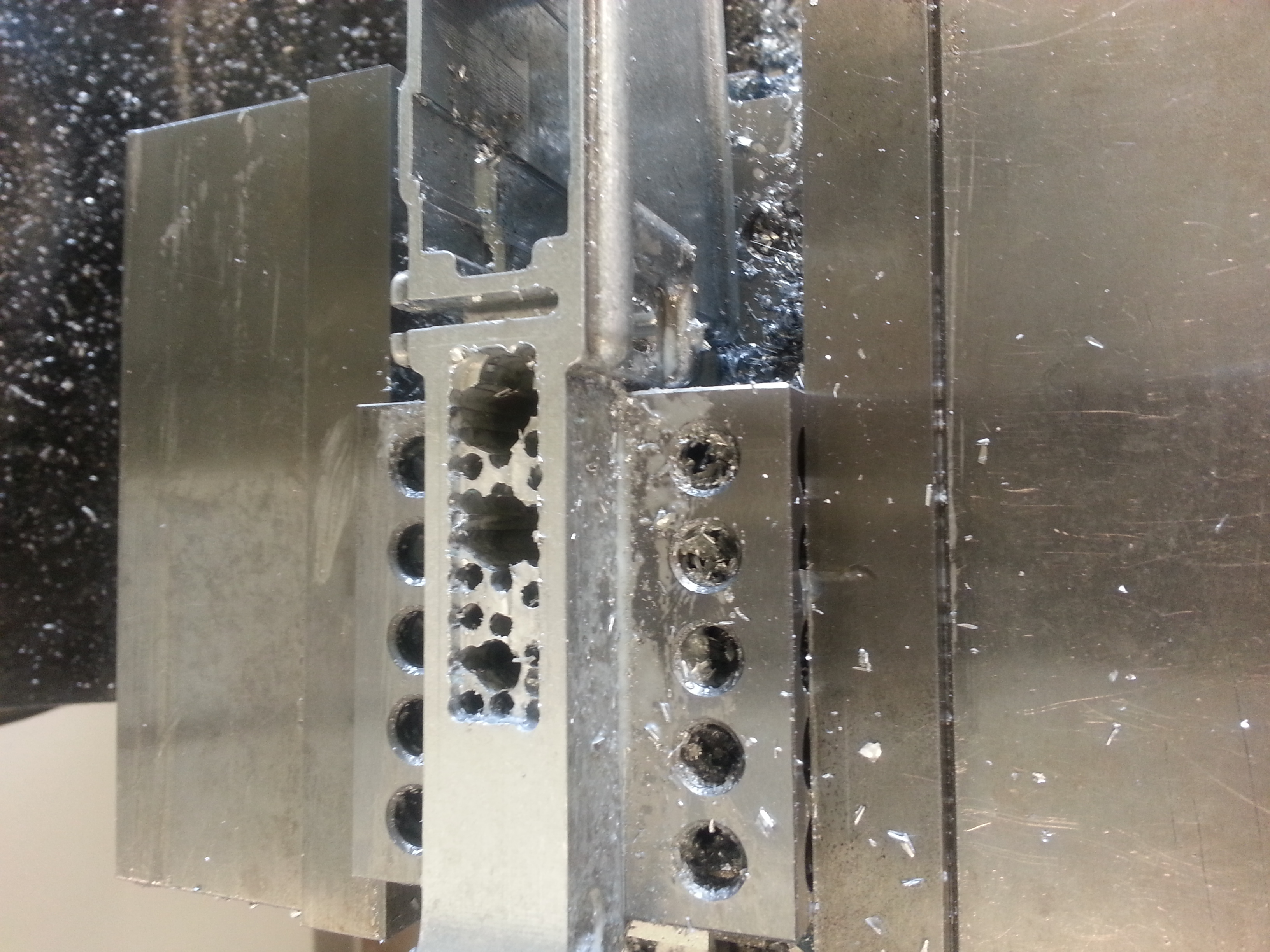

However, using any kind of mill would be better. I did mine on a mill manually, using cad drawings for the dimensions. I was lucky to have access to a legit mill for free, so it didn't cost me anything but time.

You can get a Polymer80 AR lower kit (lower, jig, bits) for $75 at Midway or Brownells, and they often have a free shipping coupon. With a steady hand and patience, you can finish that with a handheld electric drill and a Dremel. It's a good way to get your feet wet.
Completing an aluminum lower almost demands a jump up to a drill press, bench vise and a router. Or a mill, like eyedoc suggested. You could do it with handheld power tools but why? Although...if you speak Pashto you can probably do it without power tools.
