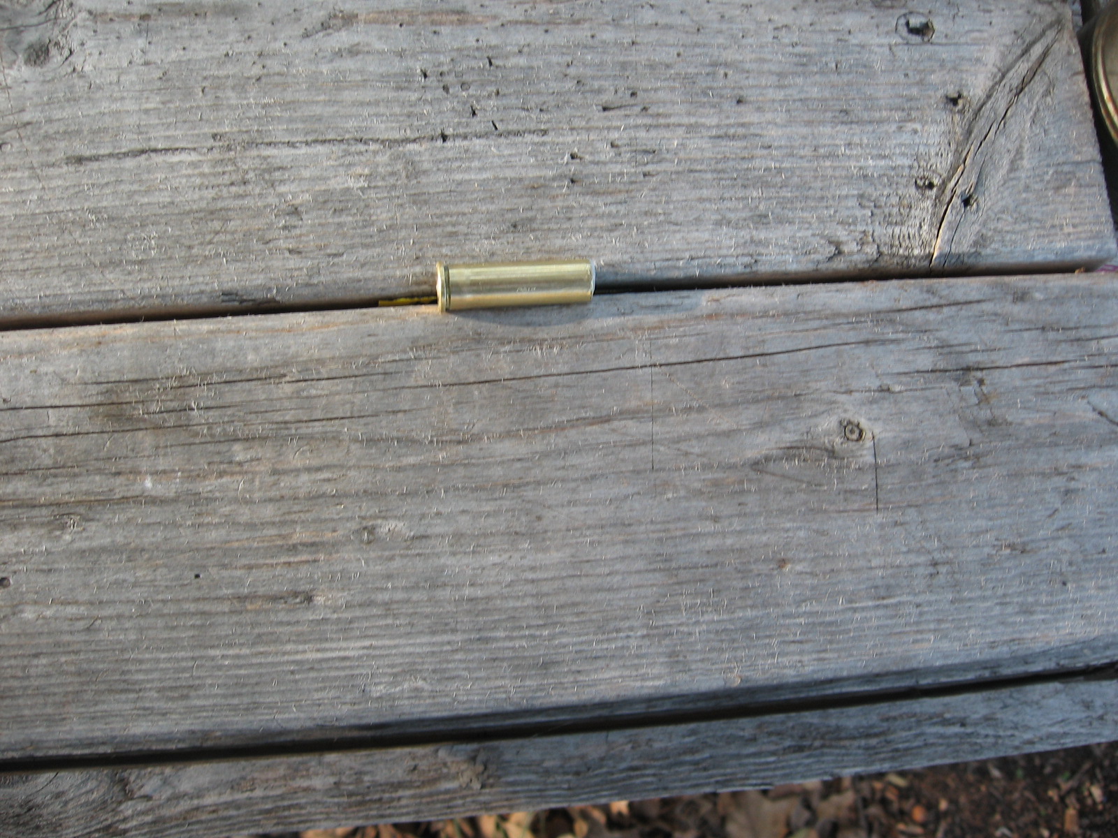

I make them in .38 Special for yard/shop/barn pest control.
My motivation was something better than the .22 LR Speers, which had a very poor pattern out of my 4" revolver (shortest .22 I have). I believe the rifling affects the quality of the pattern, and my magnum guns are 4" and longer, so I chose .38 Special for the cartridge. The increased capacity of a .357 Magnum cartridge should give you more load options. My goal was a dense pattern at a distance of at least six feet out of my 2" model 10, and low powered to reduce collateral damage. I also wanted to use what I had on hand instead of buying anything new.
#8 shot was harvested from shotgun shells. I chamfered a sharp edge on a piece of empty brass, and used that to cut wads out of cardboard cereal boxes.
2.2 grains of Hodgdon Clays, cardboard wad, 96.5 grains of #8 shot, cardboard wad, and then a heavy roll crimp. The ends were dipped in melted paraffin wax to help keep everything in place (Not a thick layer here - I just touched the top wad to the wax and let it wick into the cardboard and seal it to the crimp. The small amount on the outside was wiped away.).
Tested on a cardboard boxes at six feet; dense pattern 6-8" in diameter, and the pellets penetrated two layers of cardboard but stuck in the third or fourth.

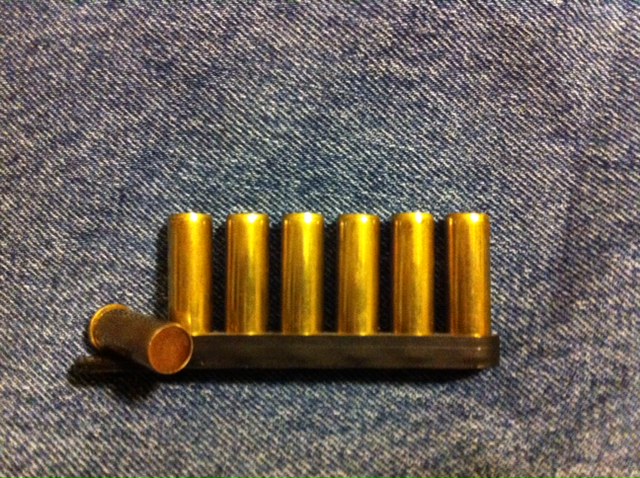

Okay, made up a dozen rounds Monday eve. 98 grs of 7 1/2 without the capsule. The best way I can describe making the first loads is like Ruger's terminology for investment casting referred to as the "lost wax" method. And I certainly lost wax. Too much to try it again, so I'll use a mini size glue gun next. It may be a few days before the weather allows us to get to the range, but more to come after that. ;-)

Well Guys, I was hoping to post some pics along the way. The Annoyed Man gave me some help, and I was able to recover my old Photobucket account. Unfortunately, none of the different options will work. Or not, at least when I check the preview for my posts. Photobucket is really kind of contrary in general as far as my "free" account.
I am taking pics though, and this will be turned into an article at the Western Powder's blog once I get the loads the way I want them. I'll post when the article goes up. ;-)

Had success with at least one pic. The other is just an overhead of the top to show the wax. With these first test loads I used a soldering iron to get the wax flush with the case-mouth. ;-)
Image[/img]
Image[/img]
