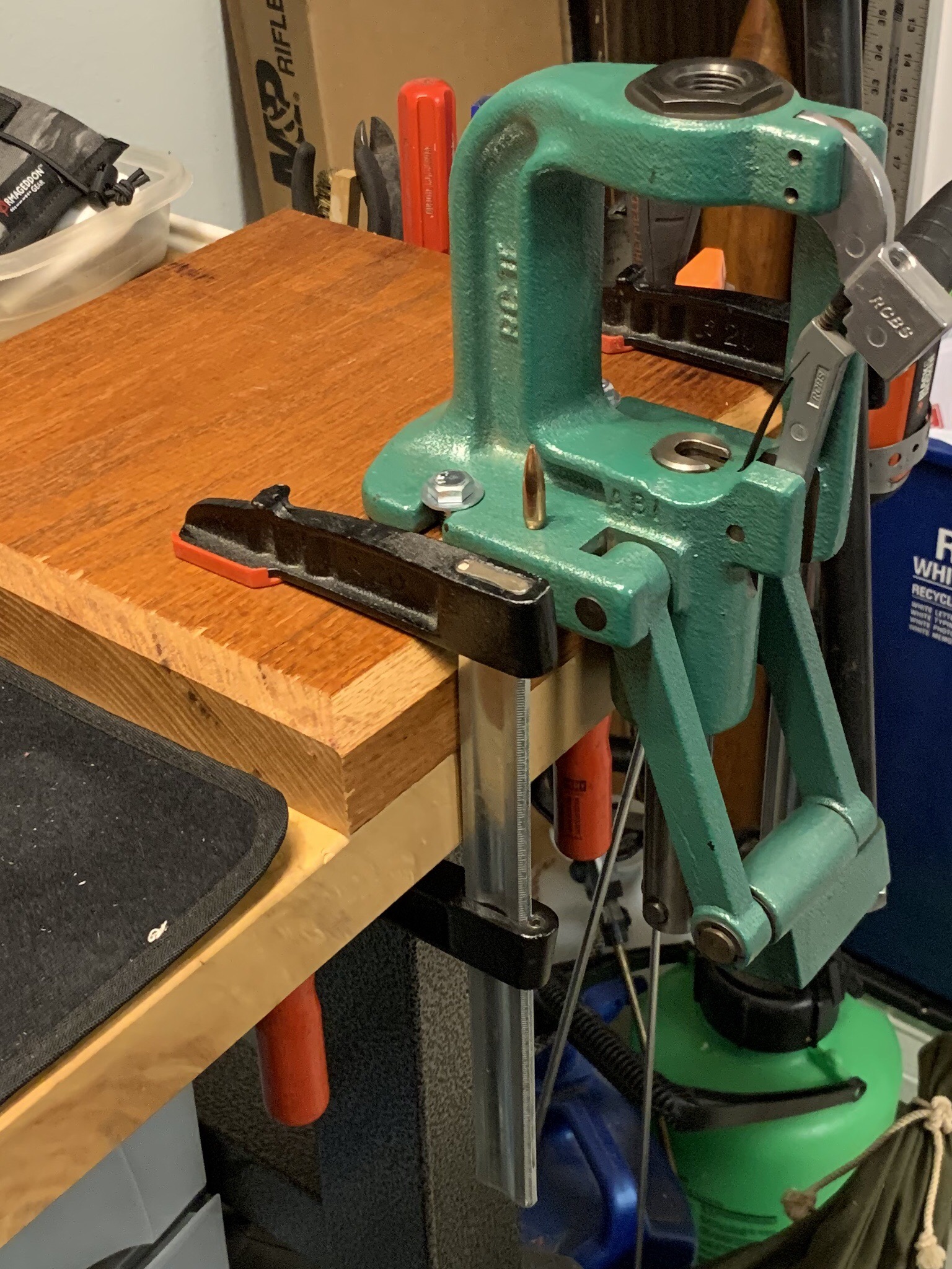

I have limited space too, so I bolted the press to a thick piece of oak, them clamp to the table. It is solid. Can always unclamped and store it. Also, LE Wilson case gauges are great for rifle, I use Hornandy case gauges for pistol. I like Lee dies, although I have other brands too.
