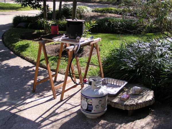

Finally got around to smelting the 150# of wheel weights I scored last summer with my home made furnace. I used a turkey fryer like Andy C & V-Rog used but I took mine all apart and made it smaller to fit a 2 qt. dutch oven and light enough I could put it up on saw horses so I didn't have to bend over it.
Pretty basic stuff; I used an old aluminum pot I got from Goodwill for the base, an old cast off burner grille from a gas stove I got for a dollar at a flea market, the wind screen, burner and hose/regulator from the turkey fryer. Its all mounted on a piece of hardy plank and 1/4" plywood. Melts a pot full of wheel weights in about 20 minutes.
Got two cornbread stick moulds from the flea market and they make nice 1"X1" X8" ingots.

P.S. How do you guys get bigger pictures in your postings?

"img" tags. If you quote AndyC's original post, you can see the BBCode.Gyrogearhead wrote:P.S. How do you guys get bigger pictures in your postings?

Thanks guys, I'll give that a try next time.Andy C wrote:Bigger pictures - well, I upload my pics to Imageshack.us, thencopy the URL and then paste that URL between IMG tags (you'll see the "Img" button just above where you type your first line of text.
