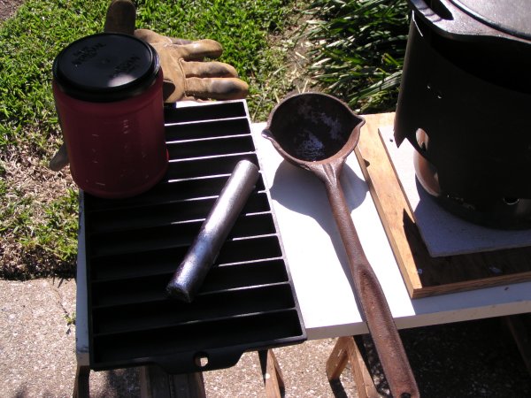

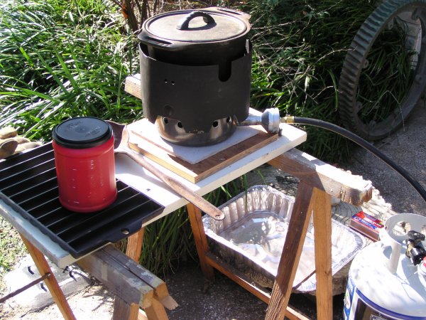

Finally got around to smelting the 150# of wheel weights I scored last summer with my home made furnace. I used a turkey fryer like Andy C & V-Rog used but I took mine all apart and made it smaller to fit a 2 qt. dutch oven and light enough I could put it up on saw horses so I didn't have to bend over it.
Smelting setup 2
Smelting setup 2
Pretty basic stuff; I used an old aluminum pot I got from Goodwill for the base, an old cast off burner grille from a gas stove I got for a dollar at a flea market, the wind screen, burner and hose/regulator from the turkey fryer. Its all mounted on a piece of hardy plank and 1/4" plywood. Melts a pot full of wheel weights in about 20 minutes.
Smelting 3
Smelting 3
Got two cornbread stick moulds from the flea market and they make nice 1"X1" X8" ingots.
