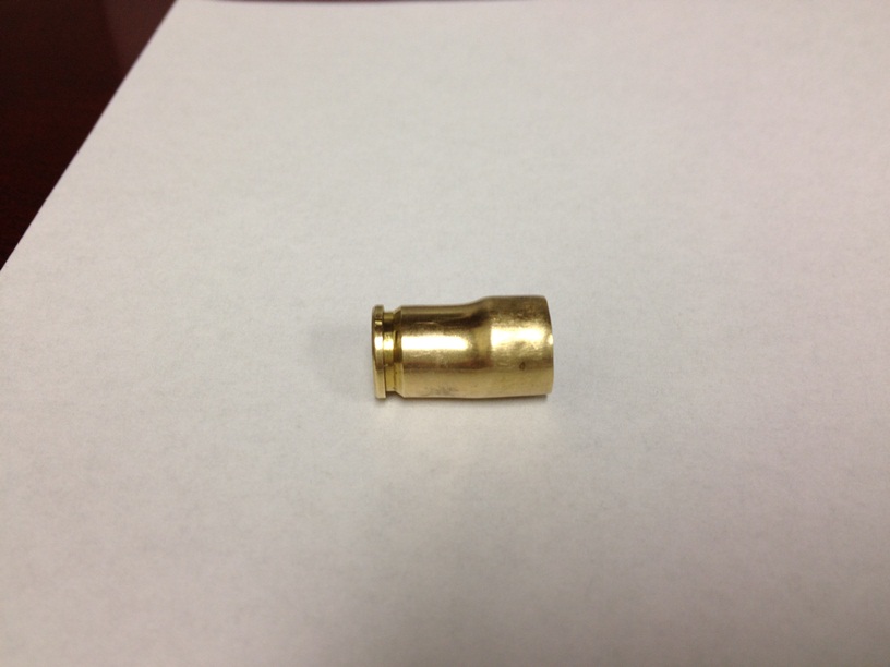

I'm with Don2, the board has been dead for too long, so I'm throwing a couple out there.
This had the potential for disaster, thankfully nobody hurt, no damage to property...
Have been teaching my 15 year old daughter both shooting, reloading, etc. She's been doing extremely well so far but I failed in one area of gun safety. I hadn't monitored her closely enough when putting ammo in the magazine.
At the range, had multiple guns, multiple calibers (first mistake). About midway through a mag she'd inadvertently placed a .380acp in a Sig Pro chambered for .40 S&W. While I would have noticed it while stuffing the mag, she is not experienced enough to have noticed (has gotten significant training since).
Apparently the extractor claw held the shell back and allowed the firing pin to strike and fire the round. To her credit, she felt like something was wrong and set the gun down for me to examine. I dropped the mag, pulled the slide back and pulled the shell (was only halfway extracted from the chamber). Was amazed to find the front of the shell ballooned out to .40. Field stripped the gun, saw no damage but put it up anyway. Got it home, cleaned it and closely examined the barrel & chamber and found no damage. Have shot it since with no issues or diminshed accuracy.
Major "Oh Crap", and a lesson learned in gun safety for me.

The very first thing is that SHE is Ok..!!!!
I'm sure you drilled her in all the safety rules.
Ya...Looks like you have a half fire formed 40 cal and 380 combo..!!
Not sure I have seen an inverted bottle neck case??
I always seem to have a problem with 380 and 9mm brass getting mixed, I bought both 9mm and 380 "OF" brass and both came with a mix...Good thing I load both.
Then I also get a few 40's thrown into my 45acp brass also.
Glad all is well now...

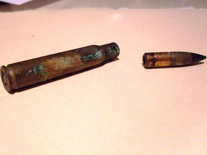

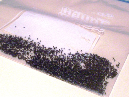

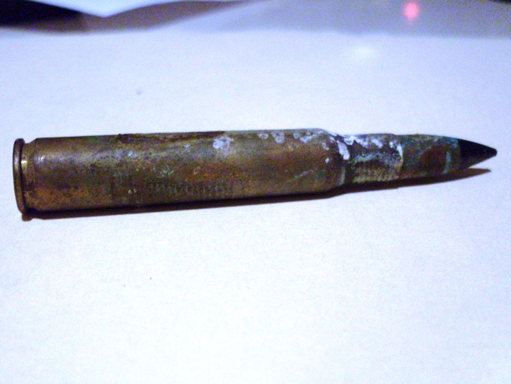

Would definitely recommend a bullet puller for the 223's. I have used mine a few times and have found it invaluable. I think I paid 14 bucks over at Carter's Country for it... definitely a low budget item.
My first use was on some 1955 Twin Cities AP .30-06 my dad brought back from Korea. It had been sitting in mom's moldy damp basement for decades and I pulled one apart recently. The round was nasty on the outside, green, correded, etc. Unbelievably the components were good... the powder burned, I cleaned the empty brass and fired off the primer in a rifle and it worked as expected. ...btw, would never have tried the shooting off the assembled round. I don't want to be a feature in the Darwin Awards book!
Some pics of that round

The pic of that 380 brass is amazing, never thought that could happen.
Glad everything is ok
