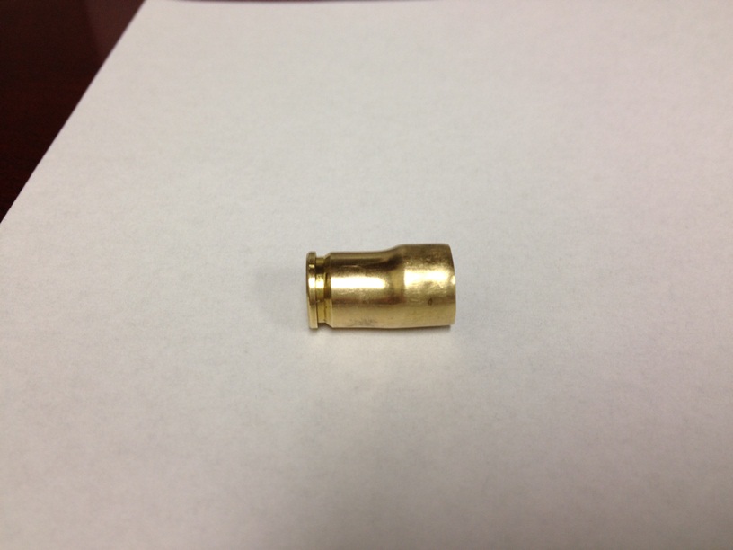

Have been teaching my 15 year old daughter both shooting, reloading, etc. She's been doing extremely well so far but I failed in one area of gun safety. I hadn't monitored her closely enough when putting ammo in the magazine.
At the range, had multiple guns, multiple calibers (first mistake). About midway through a mag she'd inadvertently placed a .380acp in a Sig Pro chambered for .40 S&W. While I would have noticed it while stuffing the mag, she is not experienced enough to have noticed (has gotten significant training since).
Apparently the extractor claw held the shell back and allowed the firing pin to strike and fire the round. To her credit, she felt like something was wrong and set the gun down for me to examine. I dropped the mag, pulled the slide back and pulled the shell (was only halfway extracted from the chamber). Was amazed to find the front of the shell ballooned out to .40. Field stripped the gun, saw no damage but put it up anyway. Got it home, cleaned it and closely examined the barrel & chamber and found no damage. Have shot it since with no issues or diminshed accuracy.
Major "Oh Crap", and a lesson learned in gun safety for me.

The very first thing is that SHE is Ok..!!!!
I'm sure you drilled her in all the safety rules.
Ya...Looks like you have a half fire formed 40 cal and 380 combo..!!
Not sure I have seen an inverted bottle neck case??

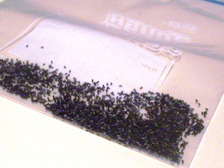

this past weekend my attention started to stray, i wasn't watching my hopper. ended up loading 20 or so 223 before realizing the hopper was dry. Luckily it was the start of another batch so i wasn't too far in. I was gonna throw the whole batch out. but out of curiosity i threw them in my vise and pulled all the bullets to see how many had no powder, how many were partially charged, and how many were full.
about 6-7 had only a few kernels, 2-3 were partial, and the rest seemed fully charged. oh well. No harm done, just a little loss of reloading components including some of my brand new cfe223 powder i was trying.

Unreal (AndyC post) that anyone would intentionally fire 380 in a 40 to save money.... Future Darwin award finalist!

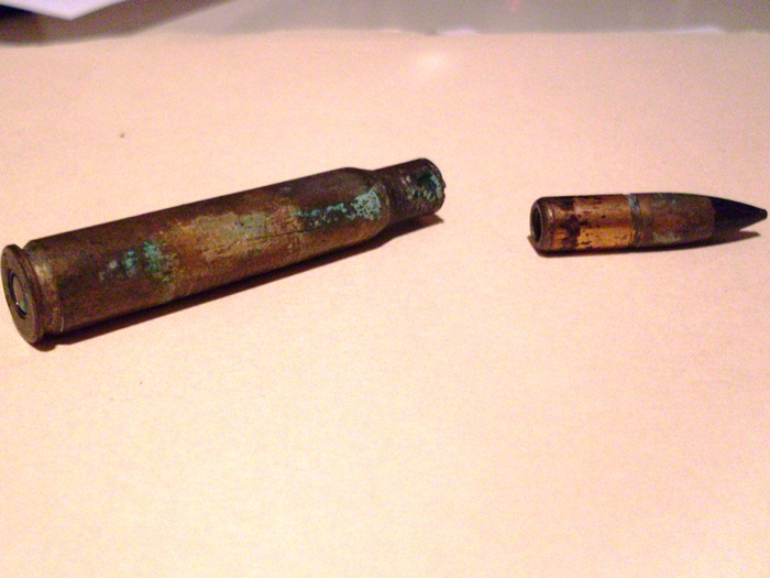

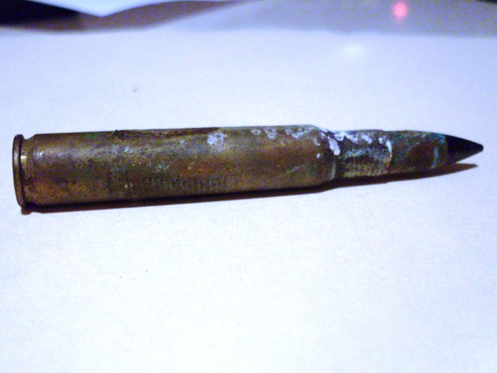

Would definitely recommend a bullet puller for the 223's. I have used mine a few times and have found it invaluable. I think I paid 14 bucks over at Carter's Country for it... definitely a low budget item.
My first use was on some 1955 Twin Cities AP .30-06 my dad brought back from Korea. It had been sitting in mom's moldy damp basement for decades and I pulled one apart recently. The round was nasty on the outside, green, correded, etc. Unbelievably the components were good... the powder burned, I cleaned the empty brass and fired off the primer in a rifle and it worked as expected. ...btw, would never have tried the shooting off the assembled round. I don't want to be a feature in the Darwin Awards book!
Some pics of that round

The pic of that 380 brass is amazing, never thought that could happen.
